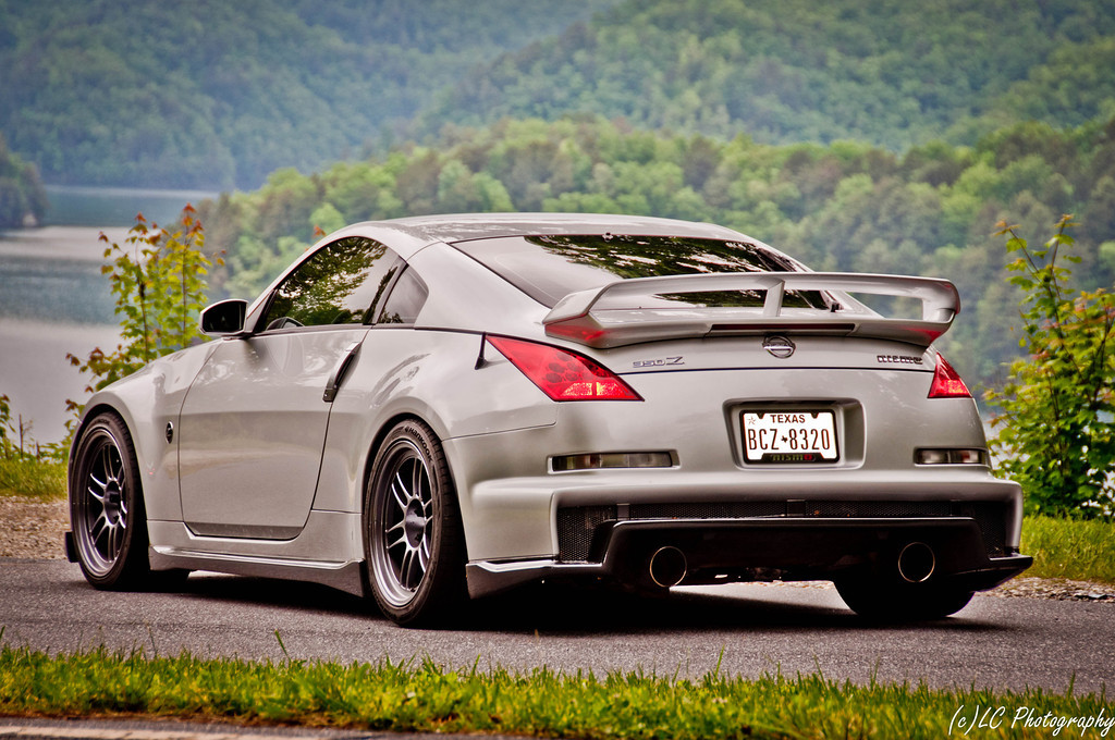

Originally Posted by mdd
decided to finally get that nismo i see! congrats on the pick up!
Thanks!
Originally Posted by KingBaby
can I see the nismo
See attached!
Originally Posted by SE5spd
Btw installed the radiator, and added water wetter/distilled water. Gonna rewire my water/oil temp gauge (potentially picking up AEM digital gauges)
Interested to see where my water/oil sits with the coolers!
My NISMO had run in the TX heat without any cooling help, so I'm hopeful!

She's beautiful
