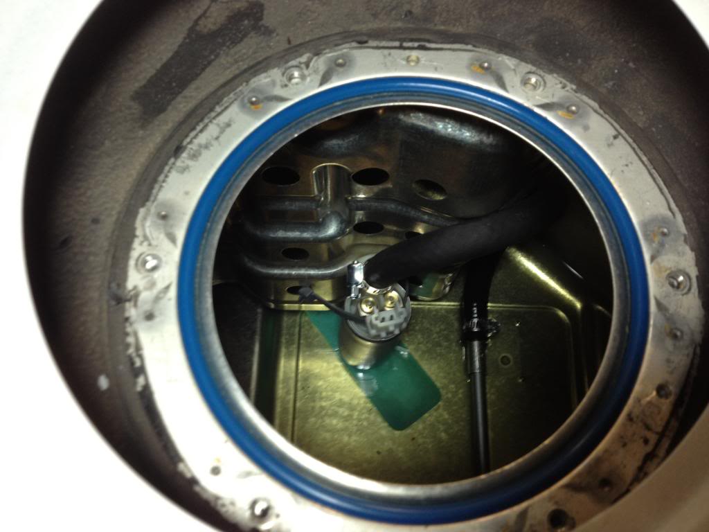

Originally Posted by Daniel M
Do you have any pics to see how to do this?
Only one but you get the idea

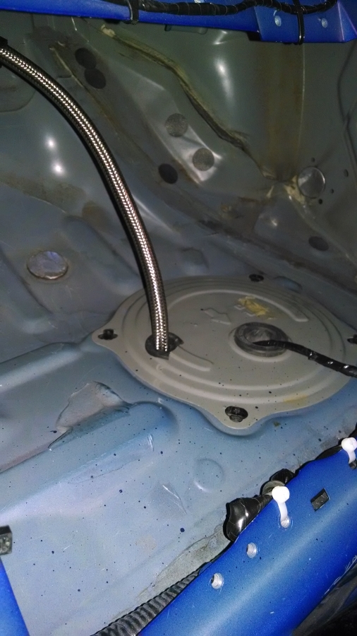

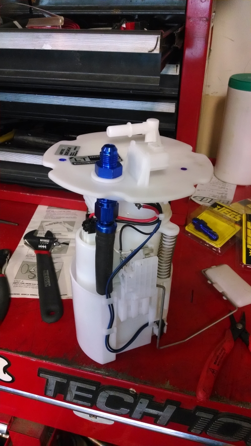

I actually wired my 2nd pump to a switch with it's own fuse and everything. I used the same style connector that is on the drivers side. I also was able to acquire the same wire harness that is on the drivers side. I just got it from a wrecked Z and cut it with about 8" of wire from the connector. I ran the fuel line inside the cockpit with a steel braided line. It's not the prettiest thing, but it works. Here are a few pics below. I can get more if you'd like. In the one pic , you can see the line coming up from the passenger side and it runs across to the drivers side. The other pic shows the 6AN fitting mounted on the new OEM pump with a short hose dumping down.
That's great info. I think I got the plumbing figured out. Although I'm not sure that I can fit another 6AN to the basket since my fuel return is already there. I don't feel good about joining them together since it could cause back pressure. I did order new pump assembly so I guess I found out soon enough.

You could run them inside the tank for sure. That would probably be a safer. I think you would have to drop the tanks though to do that. It's really hard to get in there while they're in the far. I suppose you could do it while its in the car, but it would be tough.
