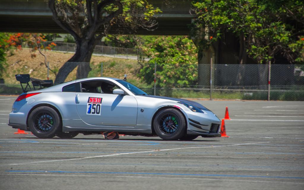

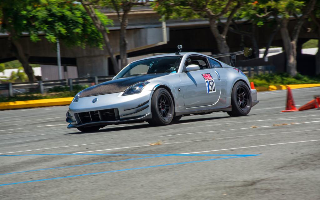

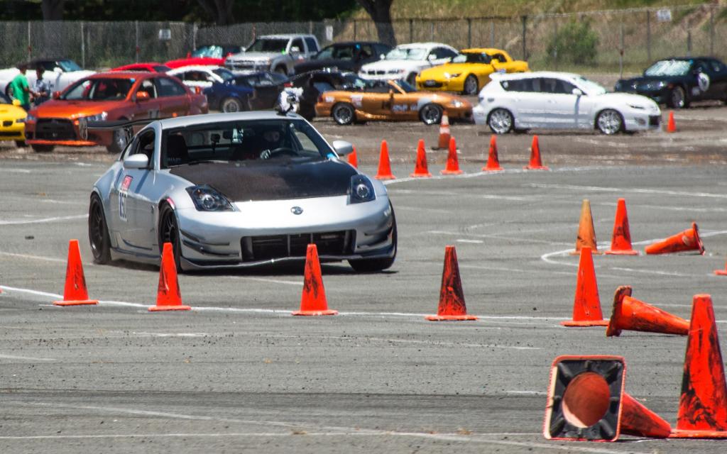

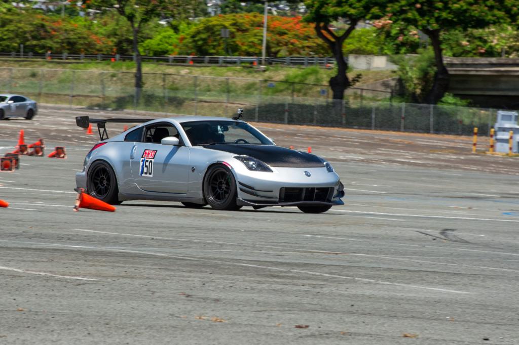

Hello all,
I'd like to share my SSM 350z that I'm still tuning and playing around with here in Hawaii as I attempt to dial in a decent setup on a budget. Mods are listed below as well as suspension settings. Any opinions to help would be much appreciated for this chassis. Pictures and videos posted for reference from this past sundays run. Thanks all!
Suspension/Brakes:
HKS Hypermax III Sport Coilovers
Kinetix Front/Rear Camber arms
Kinetix rear traction arms
Stillen Camber brace
tanabe 4pt underbrace
gt spec fender braces
gt spec front lower tie bar
gt spec rear lower tie bar
Technafit Stainless Steel Brake lines
Whiteline Differential Positive Power Kit
Whiteline Rear Traction Kit
Hawk HPS pads (f/r)
Wheels/Tires
Bridgestone re-11's (275/40/18 square setup)
18" Enkei RPF1 Matter Black (+15)
Alignment settings
Front Camber: -2.5 (Max for kinetix arms)
Rear Camber: -2.4 (Need to purchase SPC toe bolt to correct)
Toe: Stock all around
Caster: Stock
Front Dampening: 3 clicks from full hard
Rear Dampening: 18 clicks from full hard
Sway Bars: OEM
Spring Rates: 11k front/12k rear (linear)
I am going to install my front power grid endlink and whiteline heavy duty front sway (setting middle hole) this weekend. I have also just completed a amsoil GL-4 flush on my transmission and amsoil 75w-110 flush for my vlsd just before my race this past sunday.
