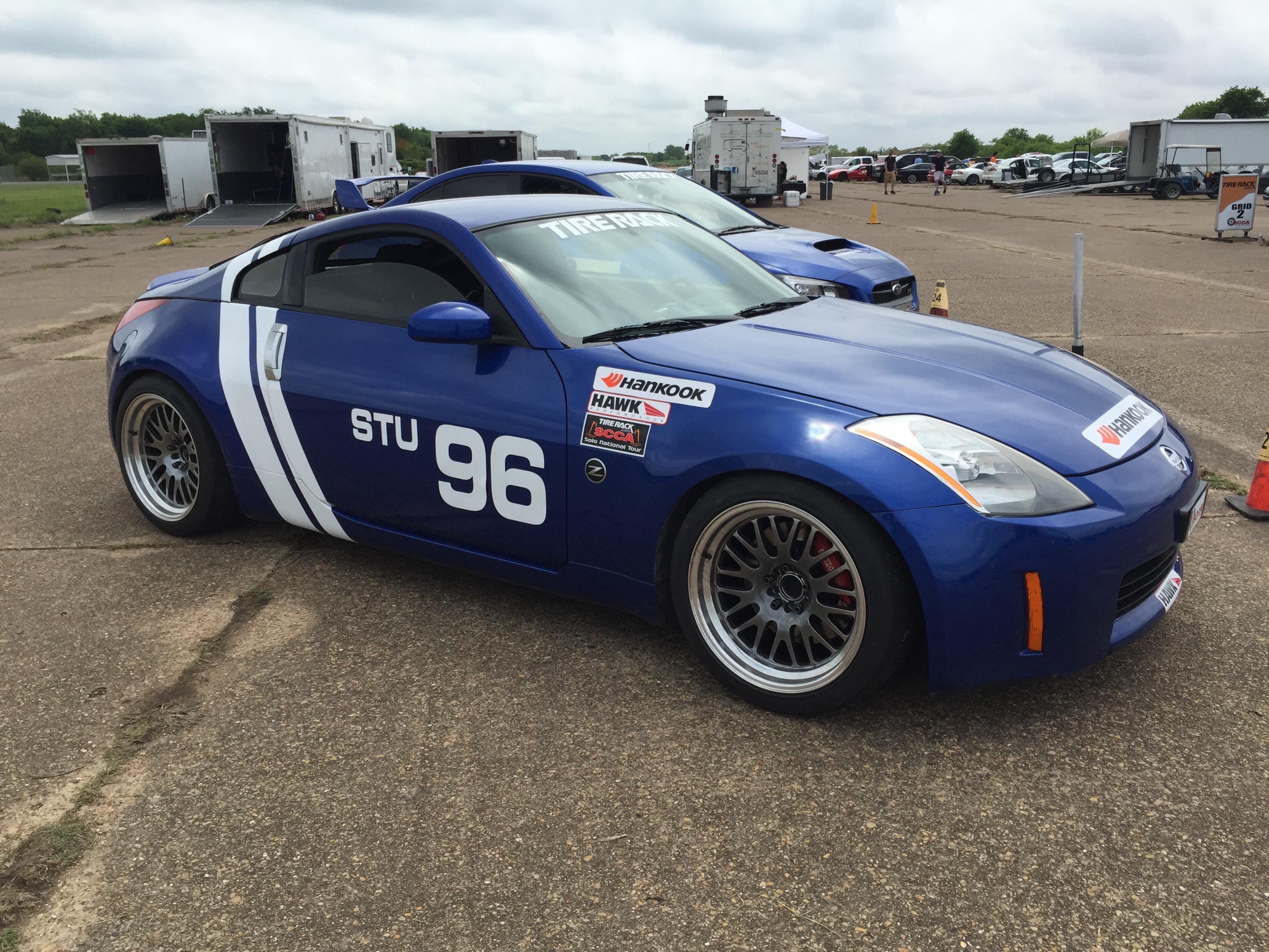

So after the first national-level shake-down the car is about where I thought it was....."Good" but not yet "great". (Same could be said for the driver)
STU had 14 drivers, I took 3rd:
I was in third after day one with 0.041 seconds separating me and 1st (STi in second and a C5 Vette in the lead) Aside from failing to get "on the cones" like I have been practicing, and a correction lift on side A, I felt like I put down a good run.
I dug a hole for myself on day two with 3 cones on my first run and never felt confident with my "plan" for side B. I held on to my third place spot comfortably, but failed to mix it up with the top two spots as I did on day one. (I was more than 0.2 seconds from the Vette that fell to 2nd and almost 0.4 second from the STi that took care of business and jumped to first.)
I'll add more about the car/setup a little later.

I'm going to replace the 800lb rear springs with 700lb springs. I have consistently needed to run my shocks near their softest settings with the 800lb springs and I still feel like the rear is a bit too stiff. I really felt like I had to be timid with the throttle to avoid slip angle on the Dixie surface.
The "bus stop" was not an issue for the single adjustables on day one, but when I ran it in reverse on day two, the bump on exit forced me to wait for what felt like an eternity before I could use the throttle for the stretch before the slalom. I don't know how much better the magic pixie dust DA's might have handled it, but I may try and find out next season.
