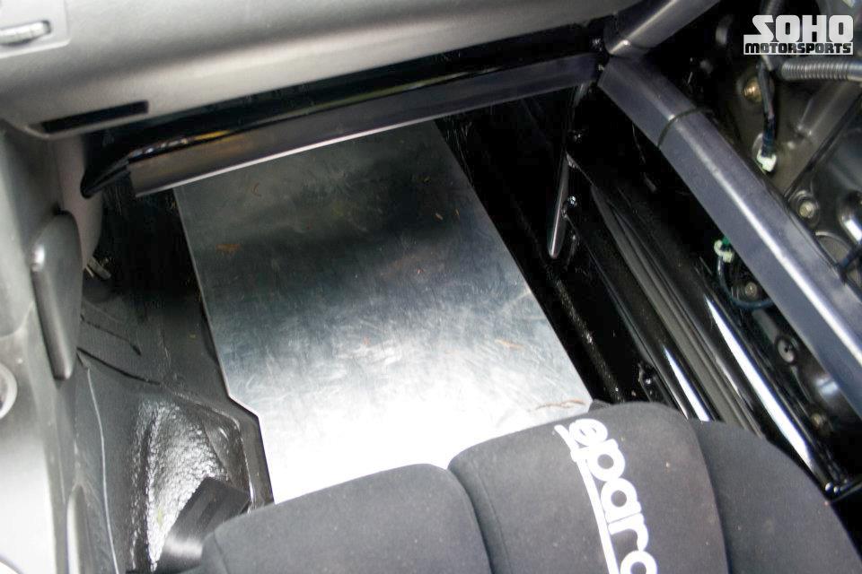

During the later part of 2012 Matt brought his lightly modified Nissan 350Z to SOHO Motorsports for upgrades as he had done a few autocross events and wanted to take it to the road course circuit. Upon arriving, he had the following modifications:
- BC BR Coilovers
- FI Test Pipes and Dual Exit Exhaust
- 18" Volk TE37s w/ Toyo R888s
- 4 Point Roll Cage
A few modification were completed that year that included the following:
-Extending the rollcage to a 6 point
-Sparco Steering Wheel, Sparco Evo 2 Passenger Seat & Evo 3 Driver's Seat
-Weight Reduction
-Defi Oil Temperature Gauge, Oil Pressure Gauge and Innovate LC1 Air Fuel Gauge incorporated in OEM stock location.
- 4.08 Rear Gear
