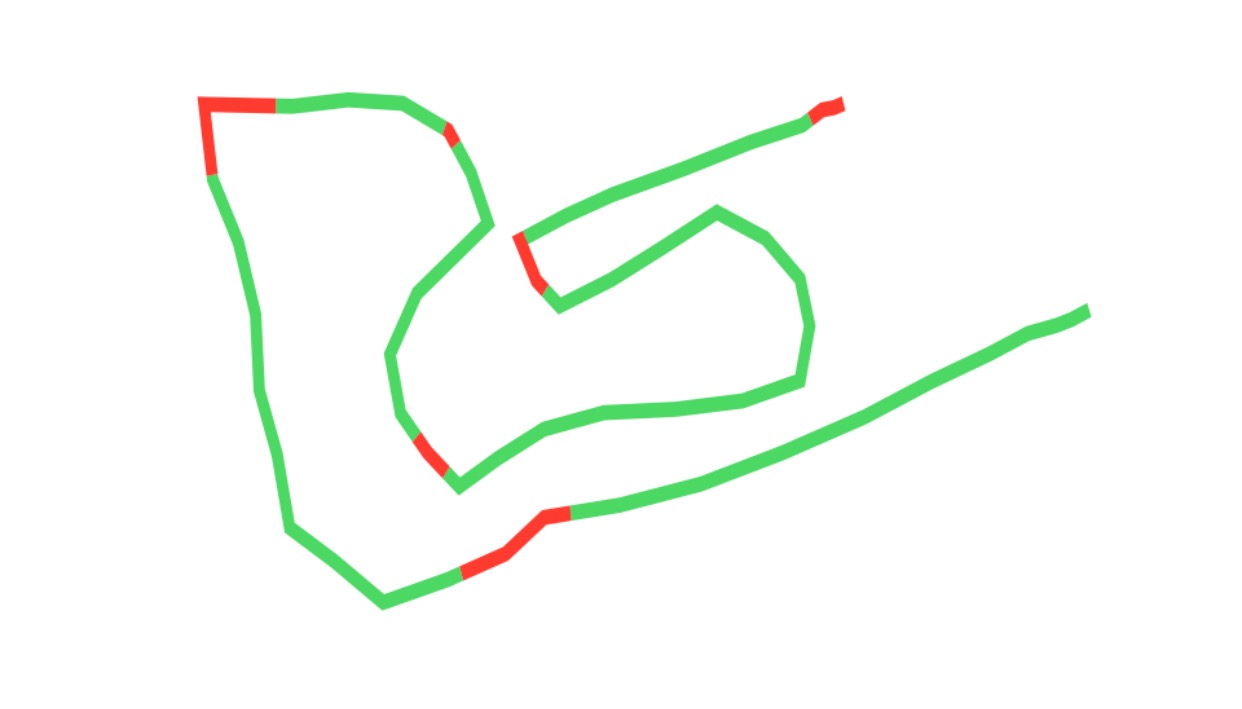

Hey guys, had a more successful weekend with NEPA SCCA. Overall, my times improved and I finished 2nd in STU, 36/90 raw times, and 37/90 PAX. I lowered the pressure in my tires a bit more than I had been and found I had great response out of them. Also made the damping harder on my suspension by a few click (probably didn't have an affect on times but worth mentioning).
Below is the information from the day- if any can see anywhere I could have gained some time please let me know! I was still behind the number 1 STU car (Subaru WRX) by 0.9 seconds!
Location: Luzerne County Community College, Naticoke, PA
Weather: Hot, humid, 88 F
Race surface: Paved, good shape
Course Map:My AutoX Journal-fullsizerender.jpg
Tire Pressure: 31/29 F/R (hot)
Times:47.921 DNF
47.803
47.021
45.811
45.675
45.730
Fastest Lap:

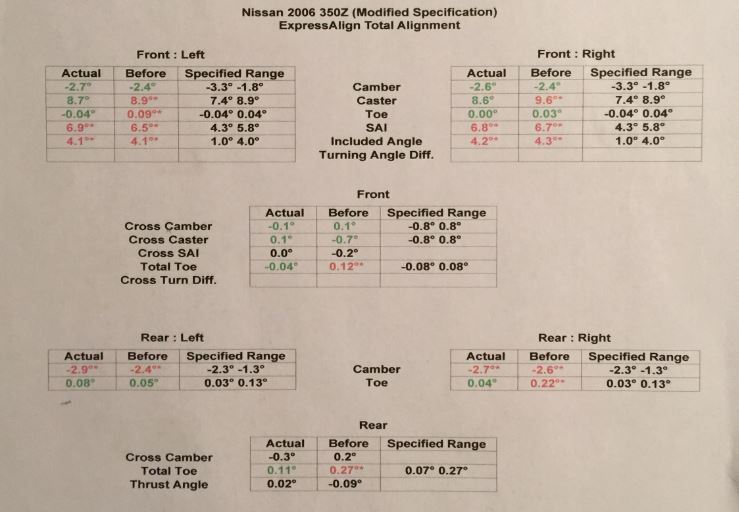

After the power was added, Z1 front upper control arms were installed. The preload on the coilovers was checked, extra hardware on the coilover mounts was removed (no idea how that got there ), ride height was adjusted to retain stock rake with square tire setup, and preload on the front swaybar endlinks was zeroed.
Finally, a new alignment with camber up front that actually makes sense! Now I can see that I need the rear camber/toe kit badly, so that will be coming up in the future. I went for a medium aggressive alignment as I also drive the car to work and around on nice days.

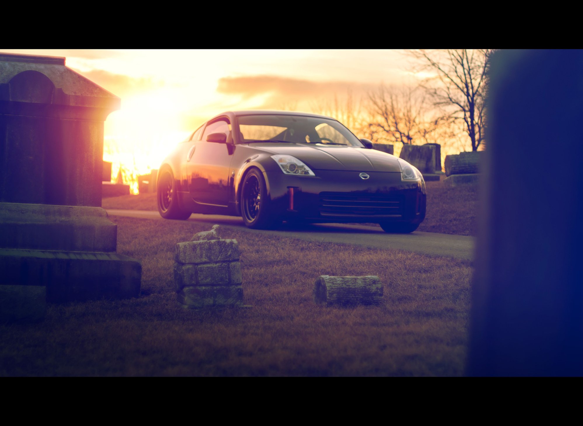

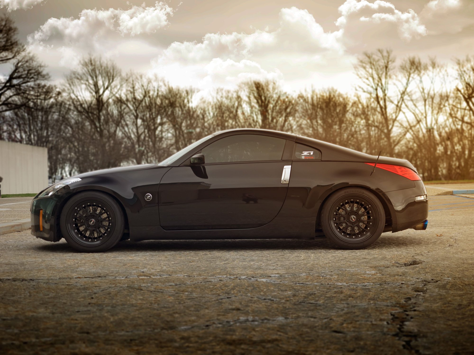

And here's a few shots of the car I took not too long ago.

Car looks good!
