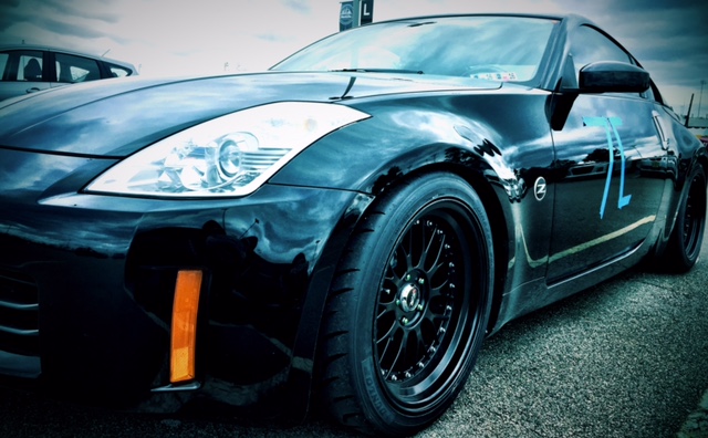

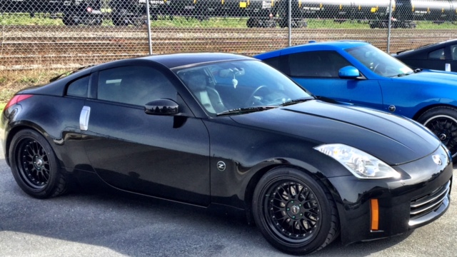

Here is the car as she sits now.

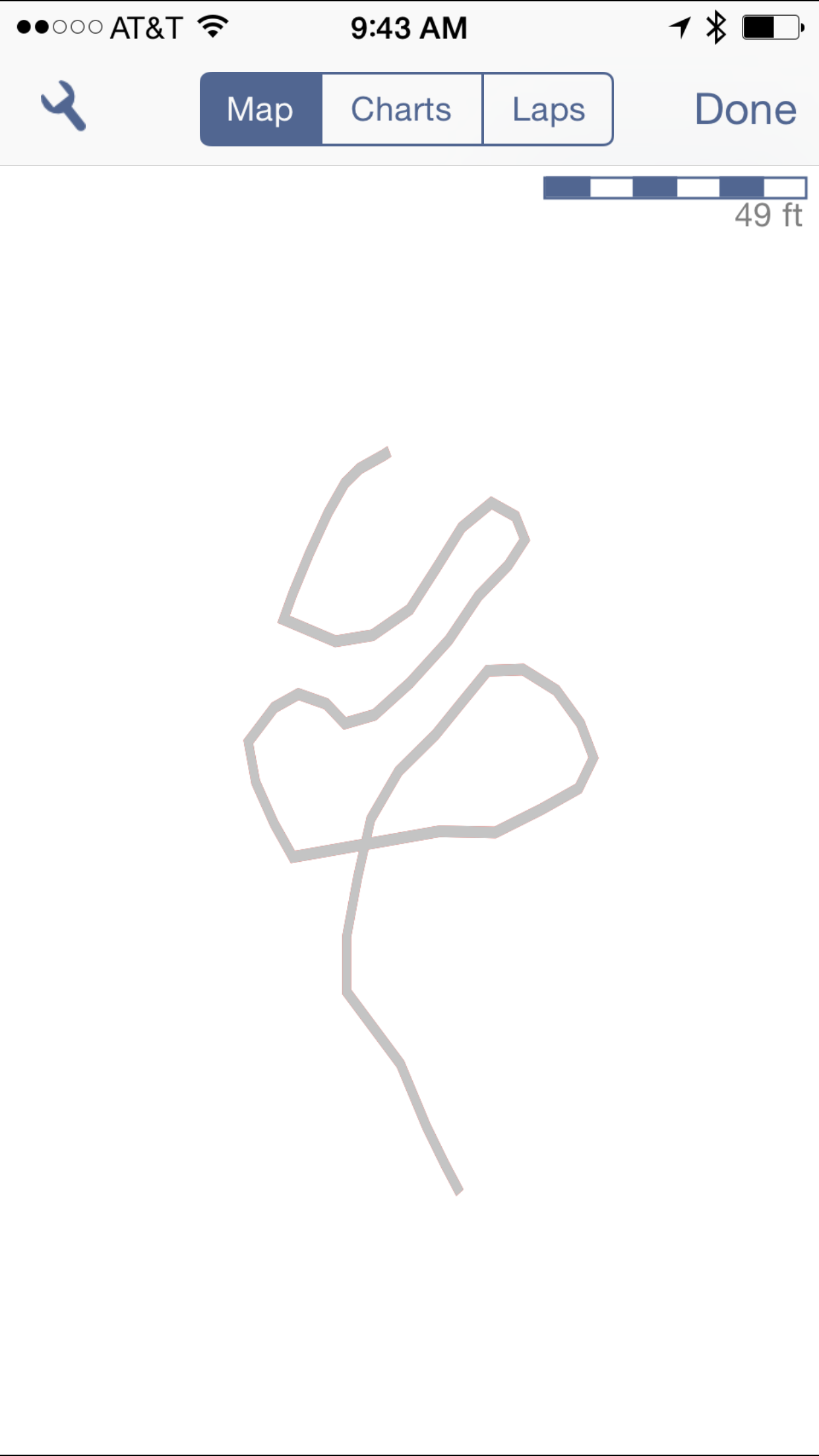

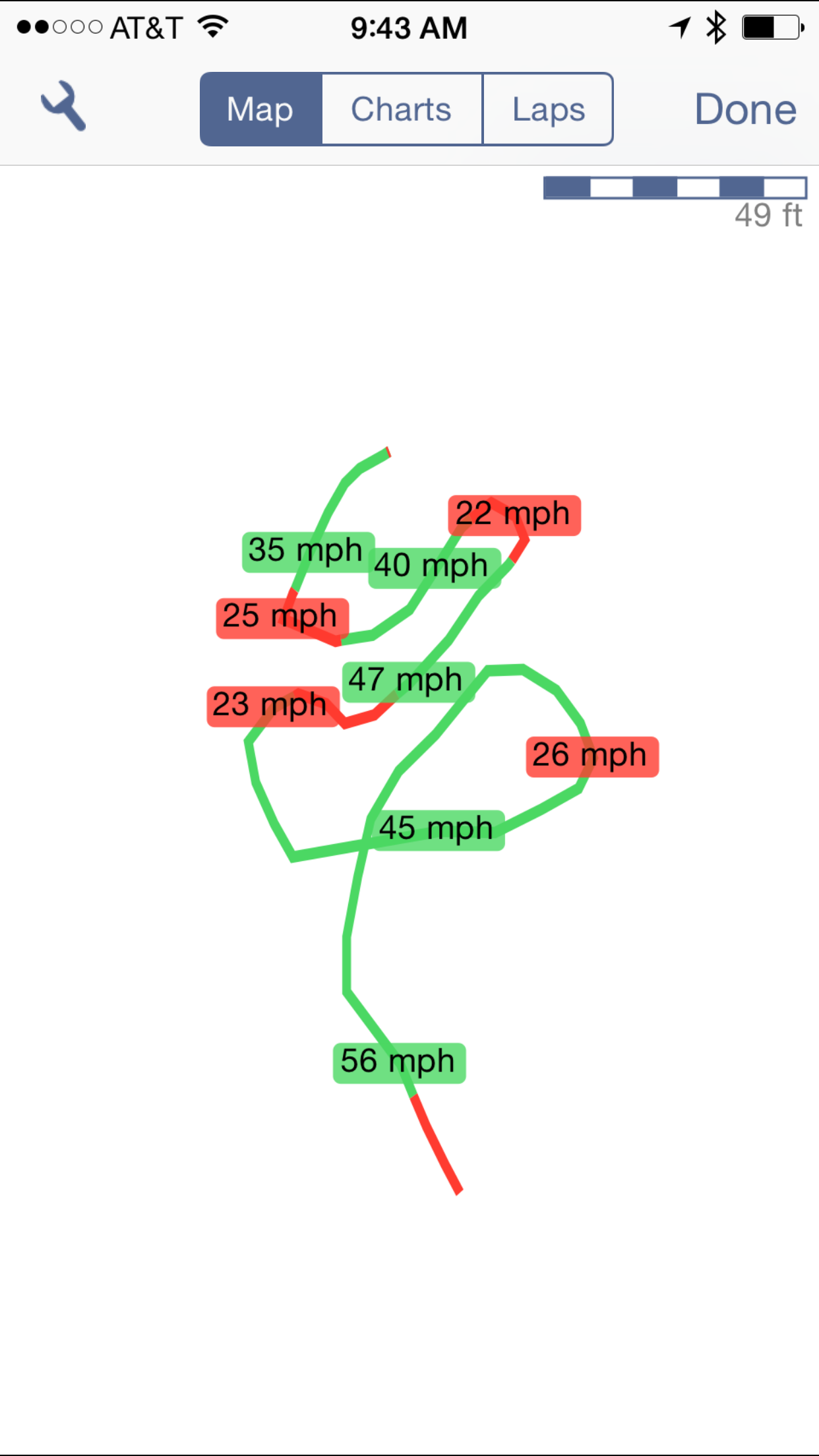

Had a very good day yesterday and got a lot of runs in. I won STU by 2.194 seconds, finished 10th in raw times and 8th in PAX times. Watching the video of my last run I feel I could have been a bit harder on the throttle in the last sweeper up to the finish and could have tracked out a bit more. It was my first time out with the Quaife and second time on the Direzza ZII Starspecs and wow does the combination of the two make a difference. Also the first time I ran without a rear sway bar. I think I'll run this way for a few more events and eventually might connect the rear sway just to see how the car feels and which I like better. Let me know your comments and anything I can do better on!
Location: Schuylkill Mall, Frackville, PA
Weather: Sunny and dry, high of 75 F
Race surface: Asphalt, lots of stones
Course map: See uploaded pictures
Tire pressures: 37/33 F/R (cold)
Times: 45.583 +1
44.842
43.302
44.298 +1
43.724
44.103
42.904
42.782
42.873
42.755 +1
42.380
42.083
Video of fastest lap.
<iframe width="560" height="315" src="https://www.youtube.com/embed/dKaQHzGRyFg" frameborder="0" allowfullscreen></iframe>
Attached Thumbnails My AutoX Journal-img_0982.png   My AutoX Journal-img_0983.png

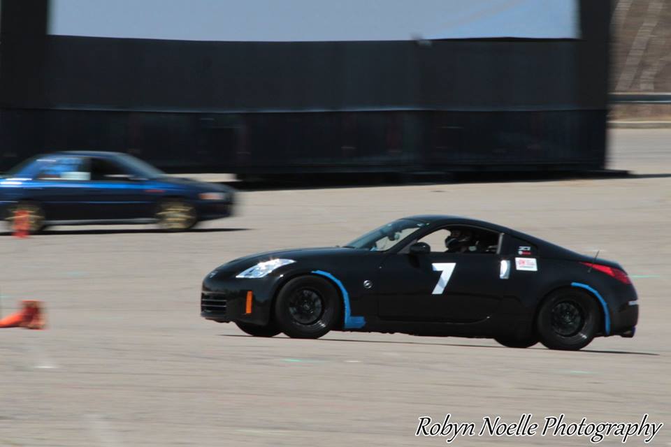

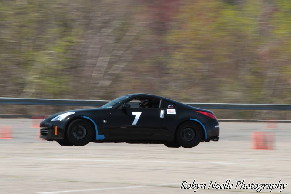

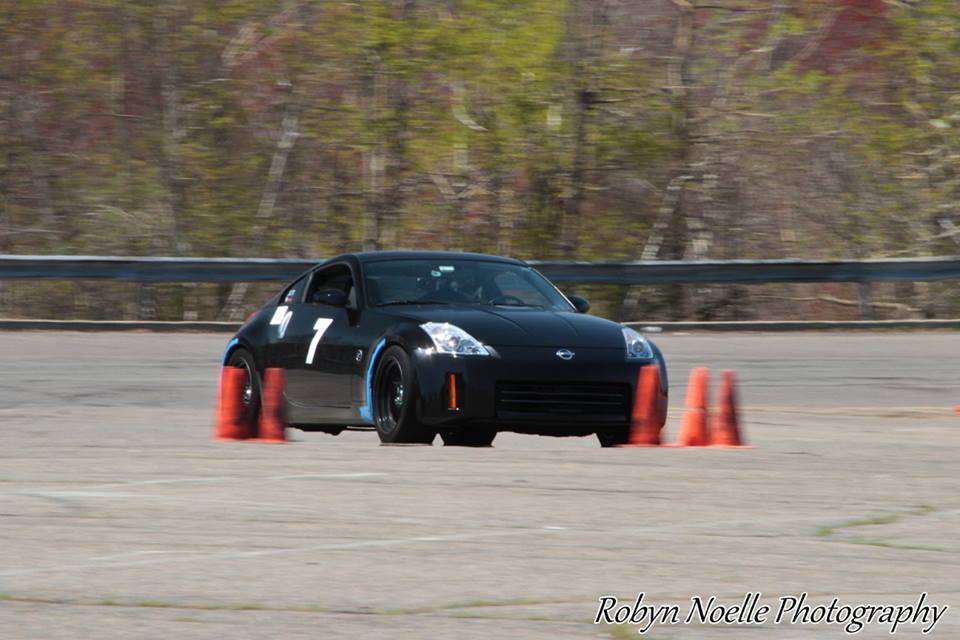

A couple shots from this past weekend's event.
Attached Thumbnails My AutoX Journal-11196266_1047558798605368_6518851859707104142_n.jpg   My AutoX Journal-11188315_1047557658605482_5780779965255978401_n.jpg   My AutoX Journal-11188426_1047557671938814_145084708295805545_n.jpg
