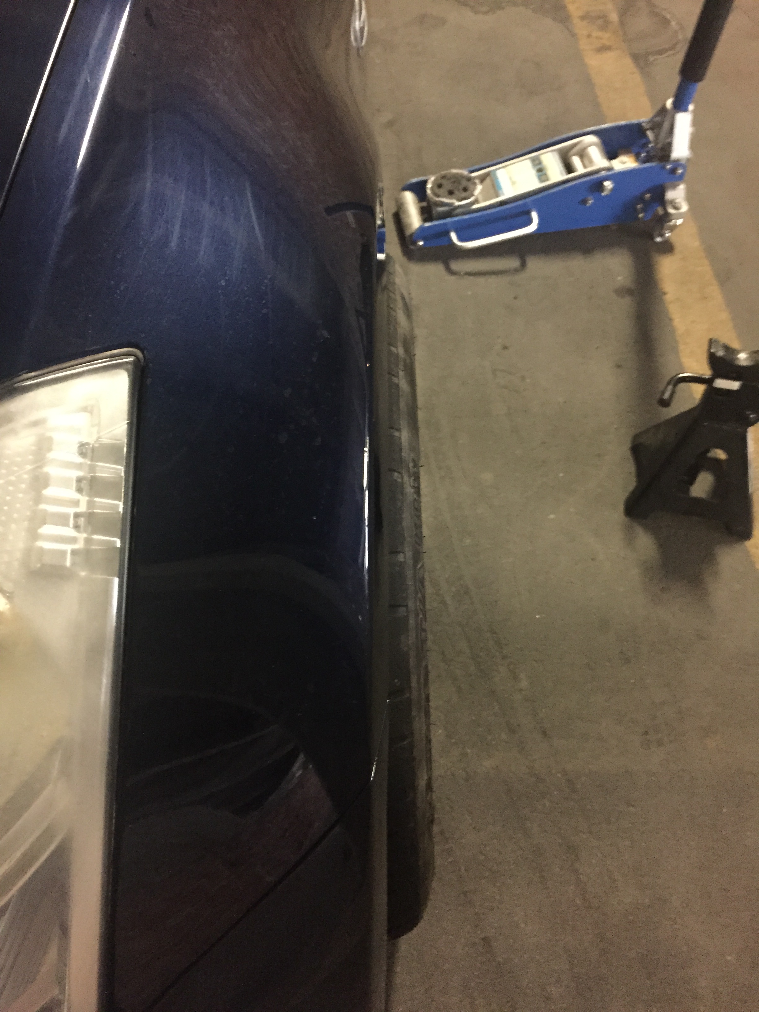

Below is a picture of the 295 BFG up front to get an idea of what I might be dealing with. The front and rear fenders are already rolled. But looks like I will need to pull and or cut the fender to keep the front from rubbing, especially after reading how people went 285 up front had to take some serious measure for proper fitment. To do this I’m considering picking up a junkyard set of fenders so I don’t have to hack up mine considering I just had the whole car painted less than two years ago.

I'm running 275F/295R tires on mine. I did not need to roll or pull my fenders at all, your offset on your rears is off.
Up front I was at -3 and the rear at -2.2 for camber. Toe was 1/16 inch out up front and 1/16 inch in on the rear. Everything is tucked in with no rolling or pulling of the front or rear fenders. I'm not sure how i'm going to get more meat up front, but I do want it.

My 18X10.5 +15 RPF1's w/285's required the rear fenders to be rolled and I run -2.5 camber in the rear. The front has the same wheels and tires with -2.75 camber. It's a tight fit.

You're going to want to try and target 3.1-3.2 up front and 2.2-2.5. I ran 315's on 10.'5s for a bit without any cutting pulling. Once you go up to 11's and 315's up front you'll become good friends with the cutting wheel.

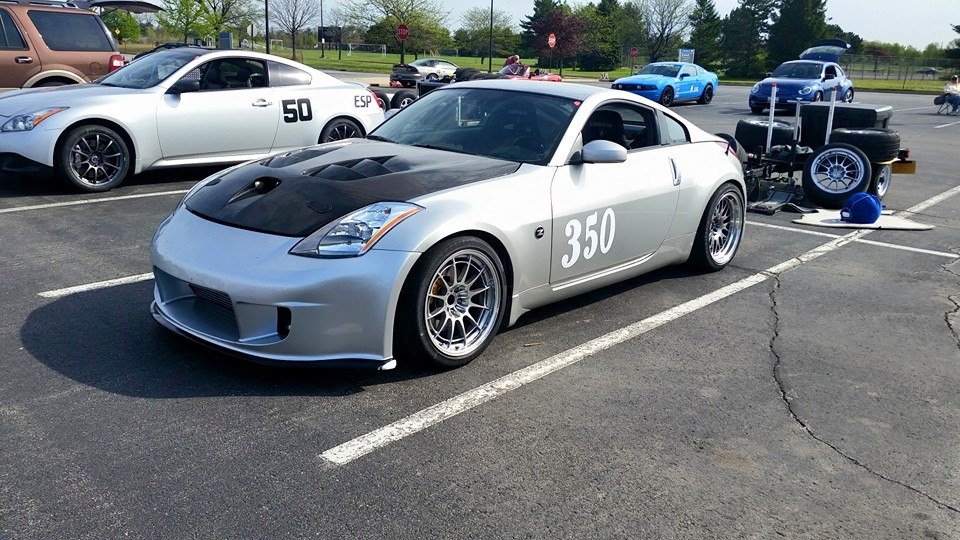

i run 295 30 r18 a6 on 18x10.5 with 20mm offset front an a 18x11 20mm offset rear. -3 camber front an -2 rear.

pic of setup
Attached Thumbnails The road to a 295/30/18 Hoosier A7 / RPF1 square setup.-11204890_10206125092260841_1205077372411112750_n.jpg

Ahh, currently the rears fit a 295 on with a 15 offset fine. They didn't before I had the fenders rolled but with the current ride height and camber they don't rub at all.

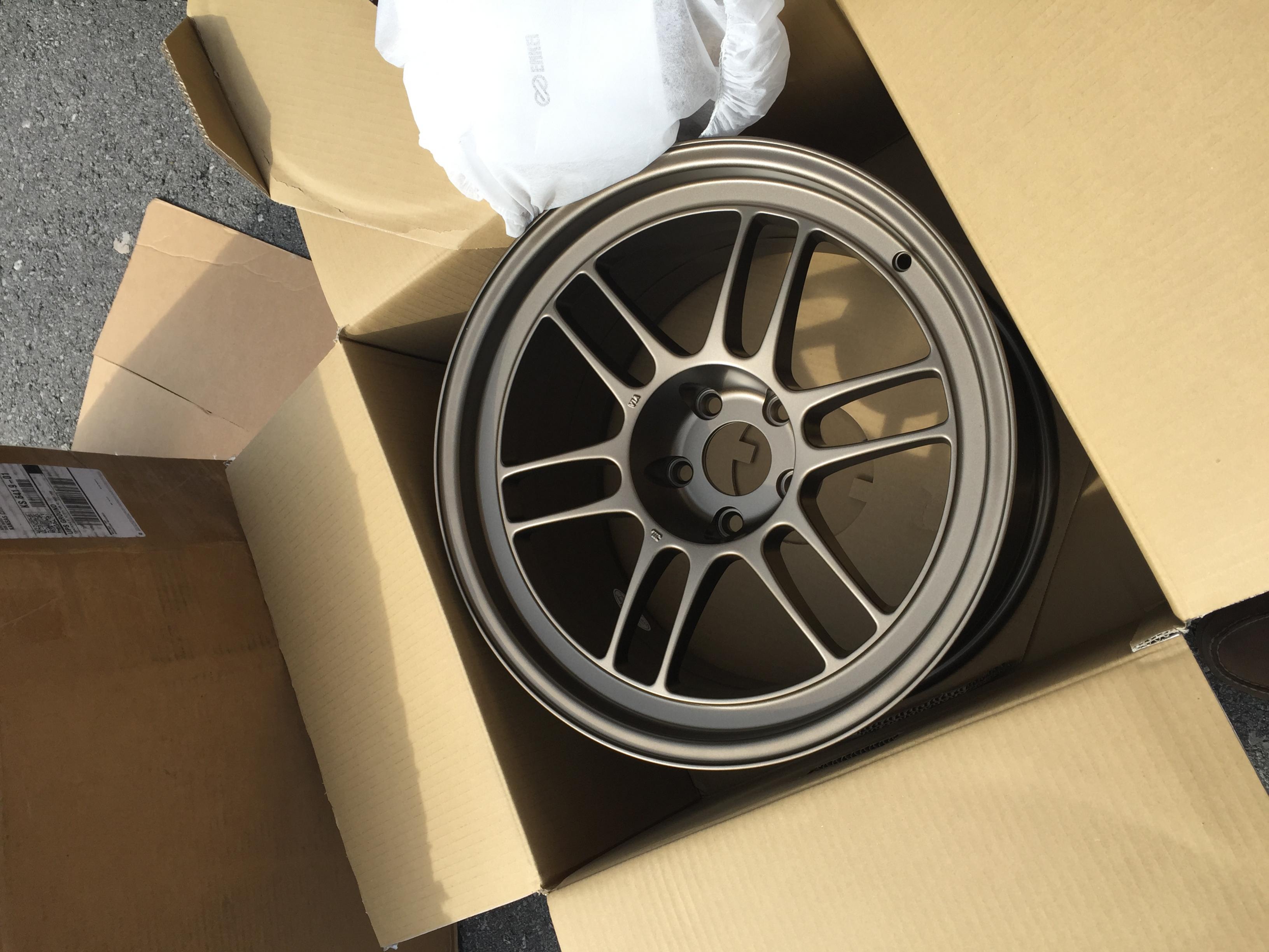

Wheels showed up today 18x10.5+15 in Bronze. My official race rubber wheel set.
I'm anxious to get the tires in and mounted.
