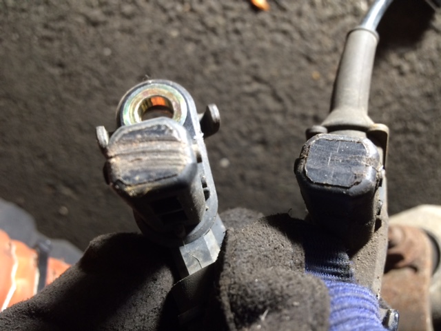

Checked the passenger front sensor today, noticed it was scuffed, took a pic to compare with the good spare sensor. Not sure if the sensor is good/bad, want to swap to the spare one, but the connector at the other end is stuck

The distance of the sensor to the abs trigger wheels is extremely important. Looking like the scuffed one is too close. Did you removed the brake dust shield? Maybe the hub bearings are flexing?
Also. The abs pump is notorious to fail, you can get replacements in the junkyard for cheap. I always carry a spare with me. I've been through a few abs pumps.
I didn’t remove the dust shield, just cut it off. I will check the hub bearing tonight.

Yea as long as you left the part of the shield I between the hub your ok.
Yea bleeding isn't that bad. Motive tool helps a ton

Well that doesn't look good. Hopefully that is why your system is going into fail-safe. Good luck.
