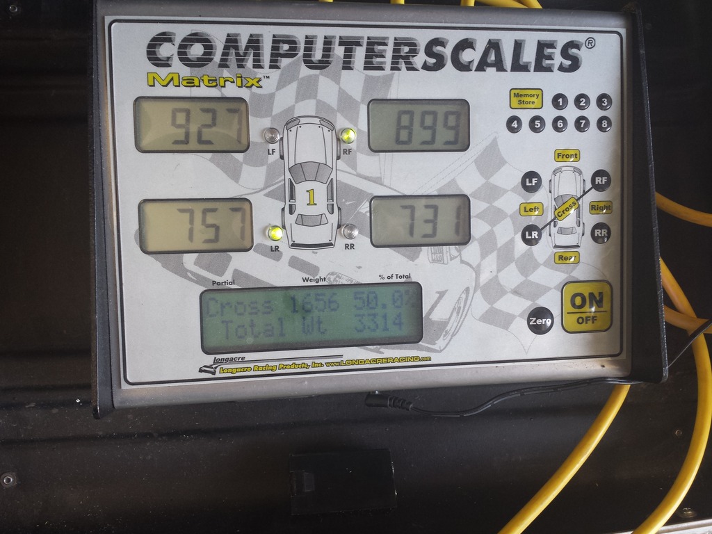

With me in the car:
Now, That's after the corner balance, but the three times I have done my car, and the handful of other cars I have corner balanced, I have never seen a single corner be so far from it's other side (left to right. before or after balancing).
I suspect the scale because his car is "missing" ~200lbs AND one lonely corner just coincidentally happens to be 200lbs lighter than it should be.
I would be less suspicions of the scales if the total weight added up.

With me in the car:

Not exactly sure if you're disagreeing with me or what but your pic shows the loaded weight - a really good side-side balance - exactly what I was saying.
But whatever the case, it definitely "could be" the scales. And if it is.... I'd sure as he*l challenge an "underweight DQ" with the scrutineers. Heh heh...
