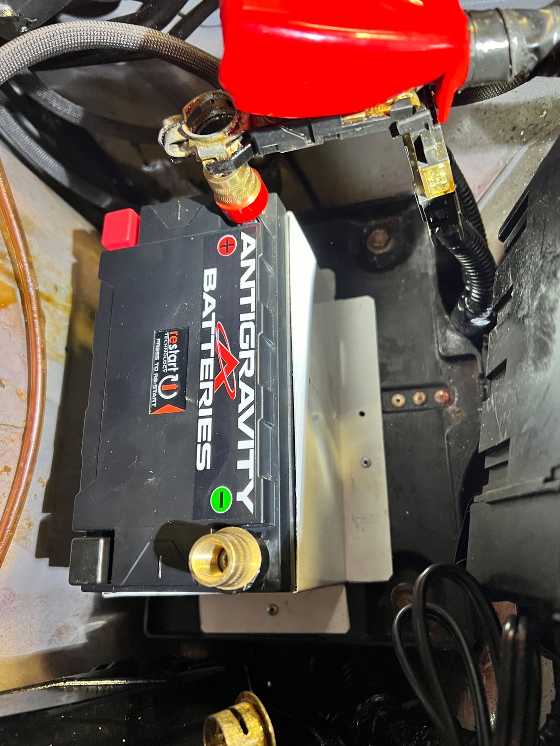

thats cool, a lightweight battery is a easy way to pickup some more weight savings. I just did one, its amazing. Doesnt even feel real.

which one is that? The one listed for a 350Z application is $830. Yikes.
https://www.pegasusautoracing.com/pr...sp?RecID=28337
its about $300, much better! The oem battery I had had 600 CCA, this one is 680 and fires it right up. you do need to buy a special charger for it too

That's not bad, thanks for the link! Any problems with an oem alternator charging the battery while driving?

that was my first thought too, how does the alternator work with that battery?

so far so good, I havent ran it on track yet. we will see!

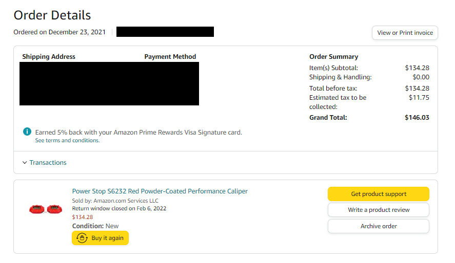

So I guess the Akebono calipers lasted 3 years. I ordered another rebuilt set as I hate doing caliper rebuild and Summit has them for $180 /pair.
Just FYI- Amazon prices fluctuate depending on market conditions. I jumped on these after a quick parts number search: front/rear calipers, pads, adapter bracket, rotors, syn fluid was less than $700 total. No core required.
Previously had rebuilt Brembos, the Akebonos (if they truly are or not) stops better, at least on streets IMO.
