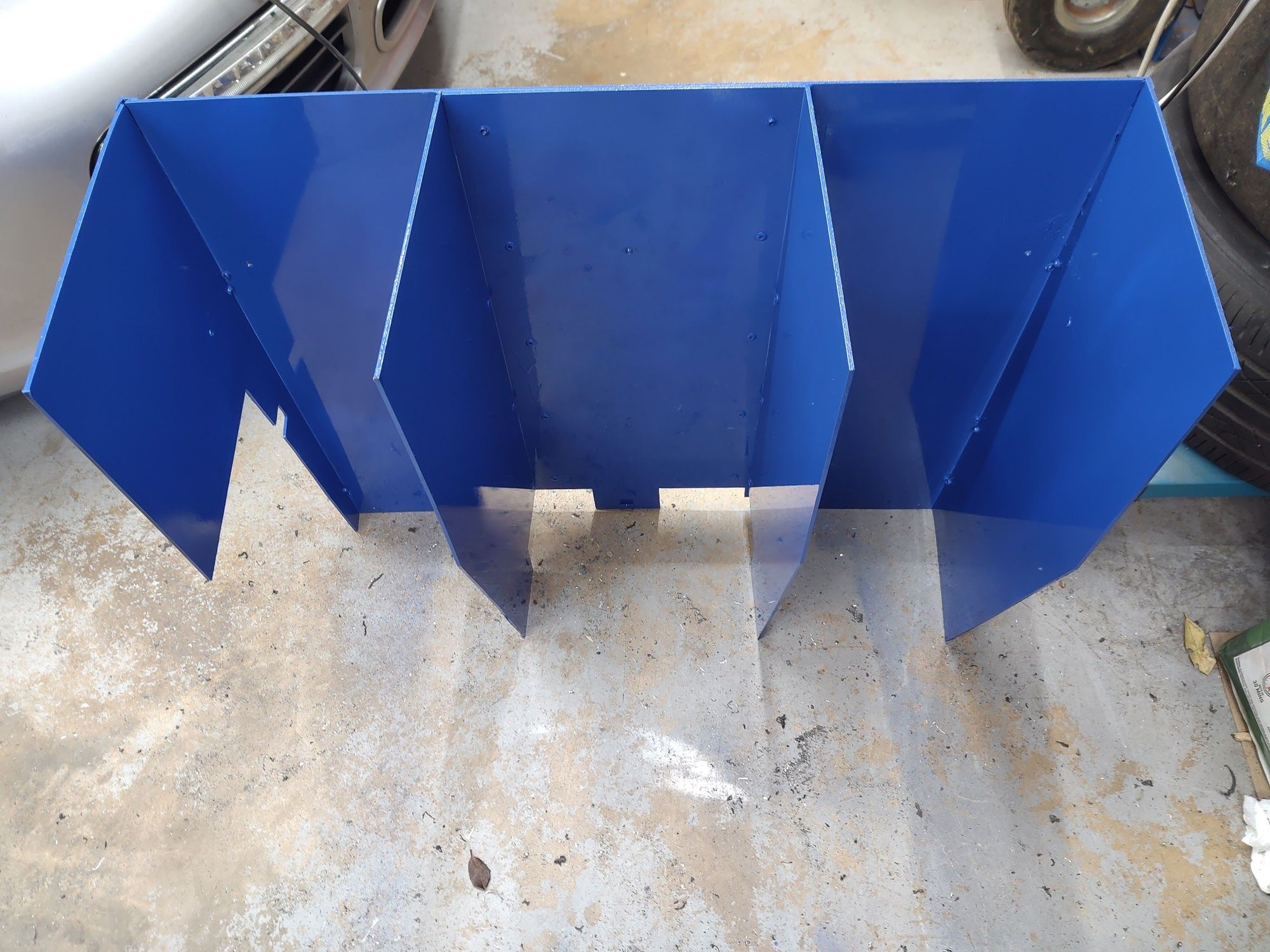

Been under the weather for the last week, but did manage to start work on the diffuser. Got the bumper cut out, front brackets installed and the general diffuser shape made up.
I'm using 1/8" aluminum composite sheets. The diffuser is 28" wide, which is the maximum that'd fit between the fuel recerculation box on the pass side and the muffler hanger on the driver side. The two fins in the middle are spaced at 9" apart. The cutout on top of the diffuser is for the diff cooler, the cutout on the right side is for the muffler. The fins will be cut down once I figure out how much ground clearance there is.

I spent way too many hours fitting, reinforcing and mounting this thing, but it's finally done. Final form of the difuser painted same blue as my cage and stripes
Here's a shot of mounts I created to attach it to your rear crash bar. I setup 3 of them across the bar
and finally the diffuser mounted
