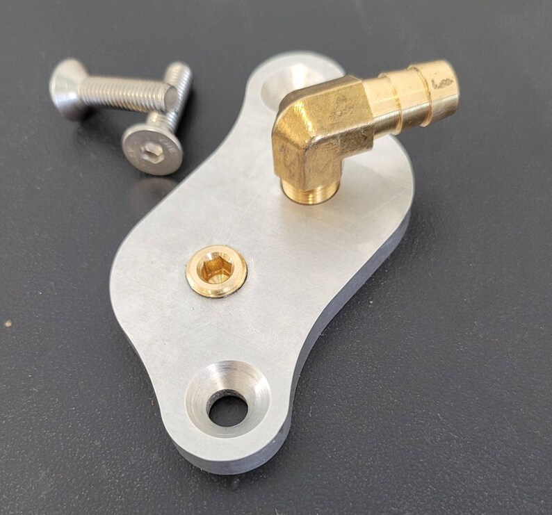

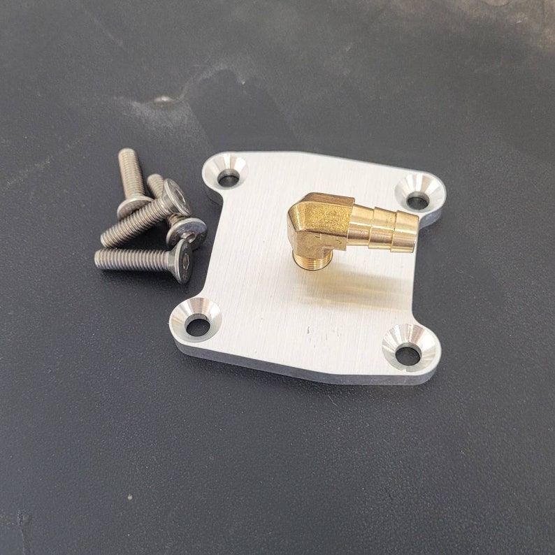

Went thru the cooling system and deleted a bunch of stuff. The coolant lines to the throttle body, the coolant lines to the oil cooler, the front cross pipe, the driver side hard pipe and most of the passenger side hard pipe.
The driver side hard pipe was replaced by a ZammyMFG block-off plate, one of the ports connects to a new silicone hose that runs to the back of the engine where the throttle body line used to plug in to provide proper coolant circulation so that the thermostat can open correctly, the other port I used to relocated my coolant temp sensor that used to be on the cross pipe.
The passenger side hard pipe was cut beyond all the nipples and I used a long silicone hose to connect it directly to the radiator
The oem oil cooler plate I left in place for now, next time I do an oil change it will be removed. I'm hoping I can simply swap the external oil cooler adapter plate in its place, but if not I did order a threaded pipe for engines without oem oil cooler (part number 15213-31U00 available at Z1 offroad).
As a result of all this I did end up with two ports open, one on the thermostat housing where the oil cooler line attached, which I plugged for now, however I will order the HR thermostat housing that doesn't have this port.
The other is on the back of the engine where a small bypass hose attached.
Since one end of the hose was attached to the heater core nipple that was cut off, I had to plug the other port. In the future I plan to reuse this port to do an additional cooling line to the engine block under the intake. A modified plate for this is available from ZammyMFG, but I'll save this for when I replace the intake manifold.

Follow up to the coolant piping mods. I ran the car a few times and I wasn't happy with the results. Despite what I've read that adding a single line from the back of the engine to the block-off plate that replaces the hard pipe on the driver's side is enough to supply hot coolant to the thermostat, it wasn't opening correctly. The temps were over 200 deg and the thermostat would not stay open, the temps would fluctuate wildly. I ended up adding a second line from the back of the engine, the one nipple I had left over that I plugged, to the port right on the thermostat housing that was also plugged. This supplies the hot coolant directly around the thermostat and it was a good fix, the temps now stay right around 180 deg, dropping to 170 when the fans kick in. I'm happy with the result and they car should now be ready for Summit open track in 2 weeks. Still waiting for Tire Rack to come and install 2 new goodyears, but otherwise it's good to go.
