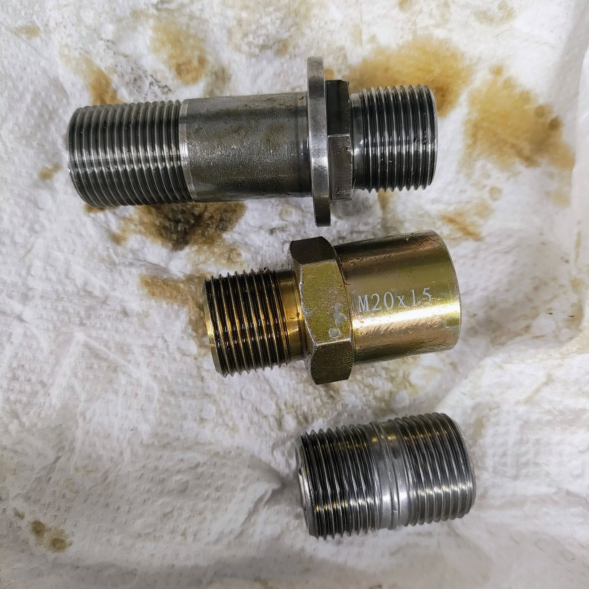

Did the oil change today and finally removed the stock heat exchanger plate while there. Used a shorter threaded pipe available from z1 off-road. Top is the stock pipe designed for the exchanger, bottom is the short one for use without exchanger, part number 15213-31U00. Middle is my external oil cooler plate extension.

So you are using the M20x5 stud for a bare oil filter setup, I assume that there is a different oil cooling setup somewhere.

Correct, there is an external oil cooler plate that's held in place by the extension piece in the middle of the picture
