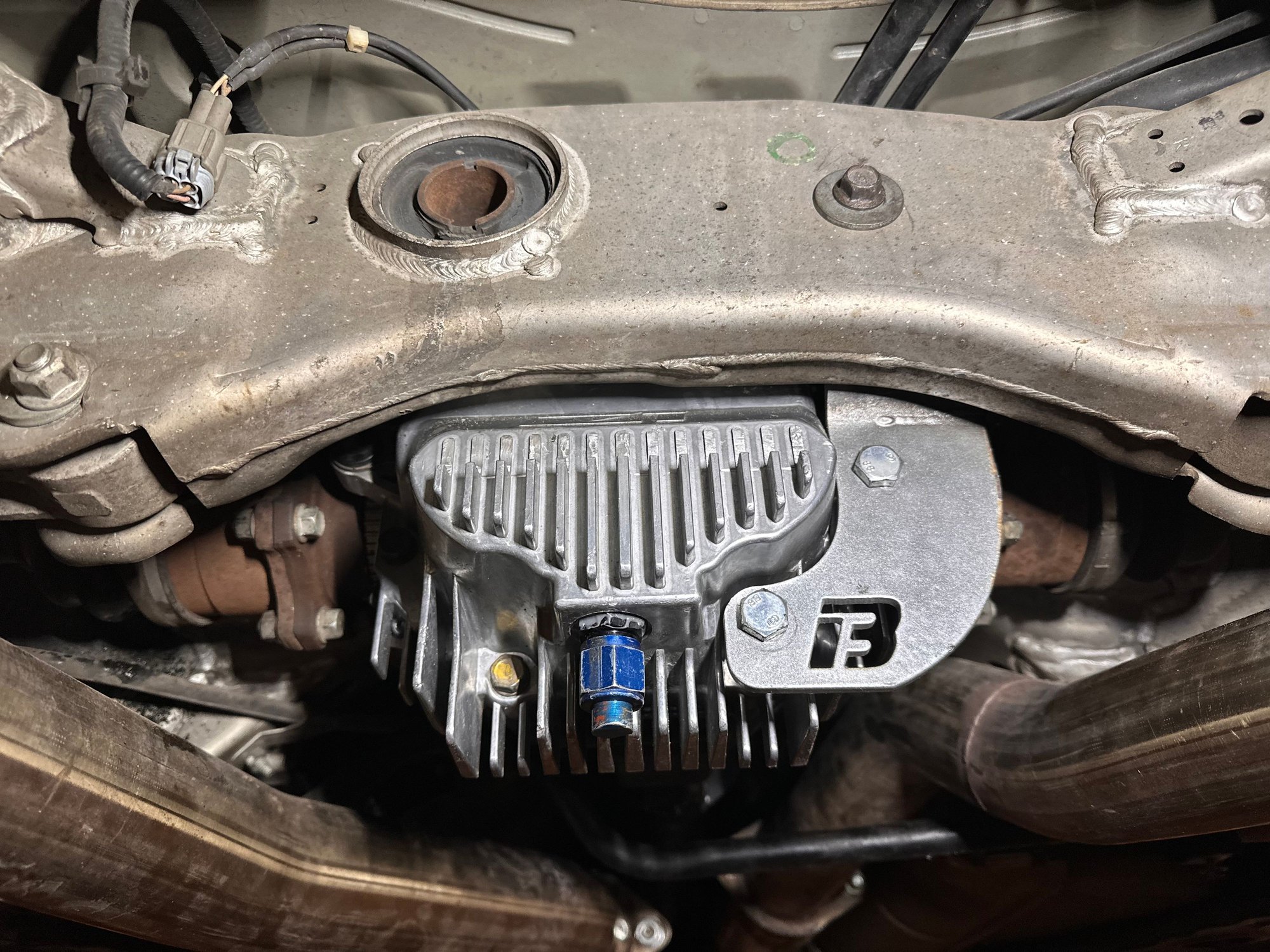

First thing I did was replace the autoparts store brakes with the hawks (previously purchased). Did some bleeding and got everything back on.
Got the koyo 48mm installed … in the process I removed the AC condenser and compressor - not my favorite thing to do but I did not destroy any fittings and can re-install/recharge at any point. I also installed a single 12” fan. The install went well and with the shroud out I trimmed the fiberglass/plastic areas to allow better airflow (more on this later). Spent a few hours (attempting) to heat cycle and bleed the cooling system and it sorta worked but bit-the-bullet and got a lisle coolant funnel. Did about 70% water, two bottles of water wetter, and ~25% antifreeze … gotta have a respectable portion of antifreeze as the car does stay outside at times.
Also got the power steering cooler and bigger reservoir installed. The reservoir is (calcs out to be) around 1.4 quarts - which I’m pretty happy with. I welded brackets to the OEM crash bar in a similar fashion to the oil cooler.
I got the horrible downpipes off and the single exhaust off the car. Test pipes installed and a AAM true dual exhaust installed. Its still sorta droney around 2k rpms but it sings at anything higher than 4krpms (more on this later). Had to redo / adjust / reweld some brackets but it was able to hang it from the OEM mounts. I also replaced 3”dia / 6” long flex sections which were worn through from the previous owner - which made install pretty easy.
With the car up in the air I dropped oil, transmission fluid, and diff fluid and put fresh fluid in the car.
Picked up a pretty beefy windsheild mount and running track-addict off my phone. Really having fun with it.
Got the car 100% done and got 15 to 20 miles on it to ensure its ready for the track … everything was great but I got a P0128 - coolant below temp … did notice that my temps rarely got up past the 9oclock mark (in my test drives) but the heat was blowing hot air and both radiator hoses were hot. I dont know if the water/water wetter/coolant along with the bigger radiator were doing a above average job?? But I didnt freak out about it.

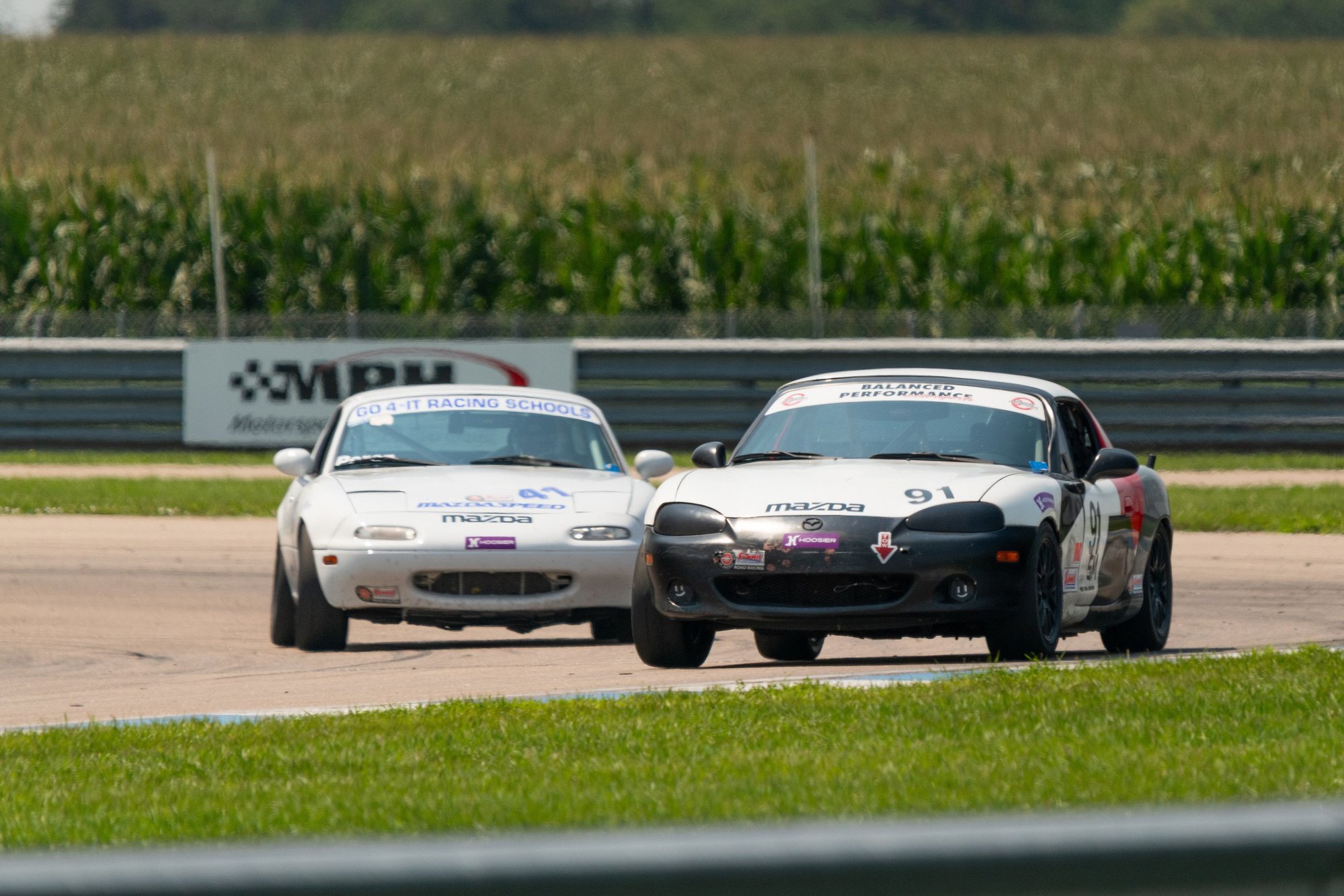

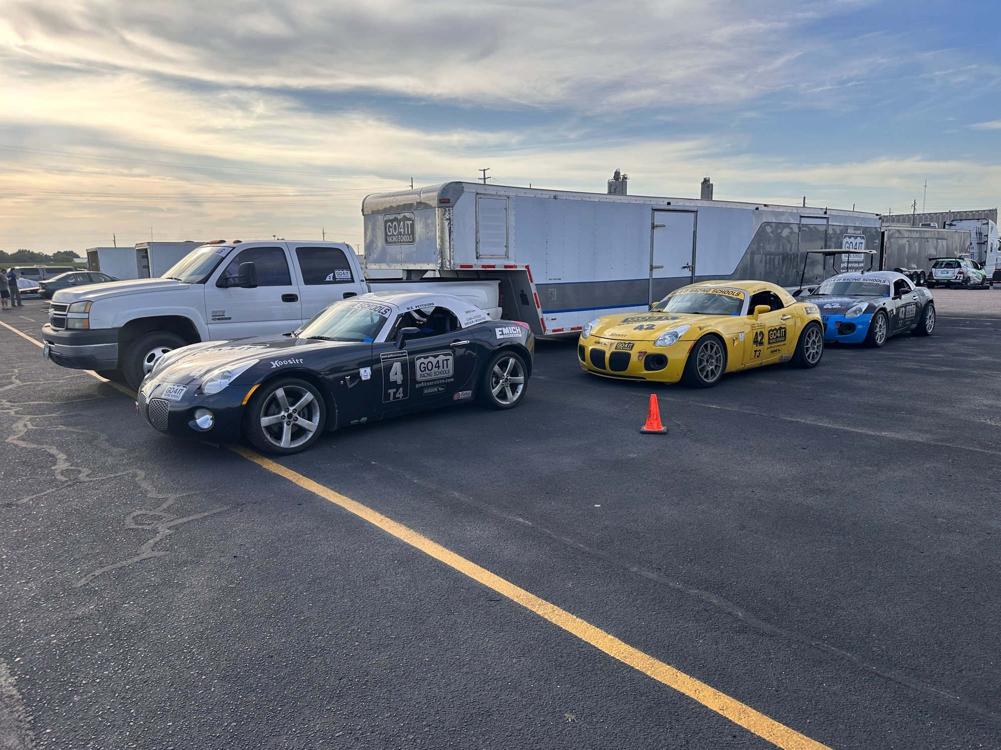

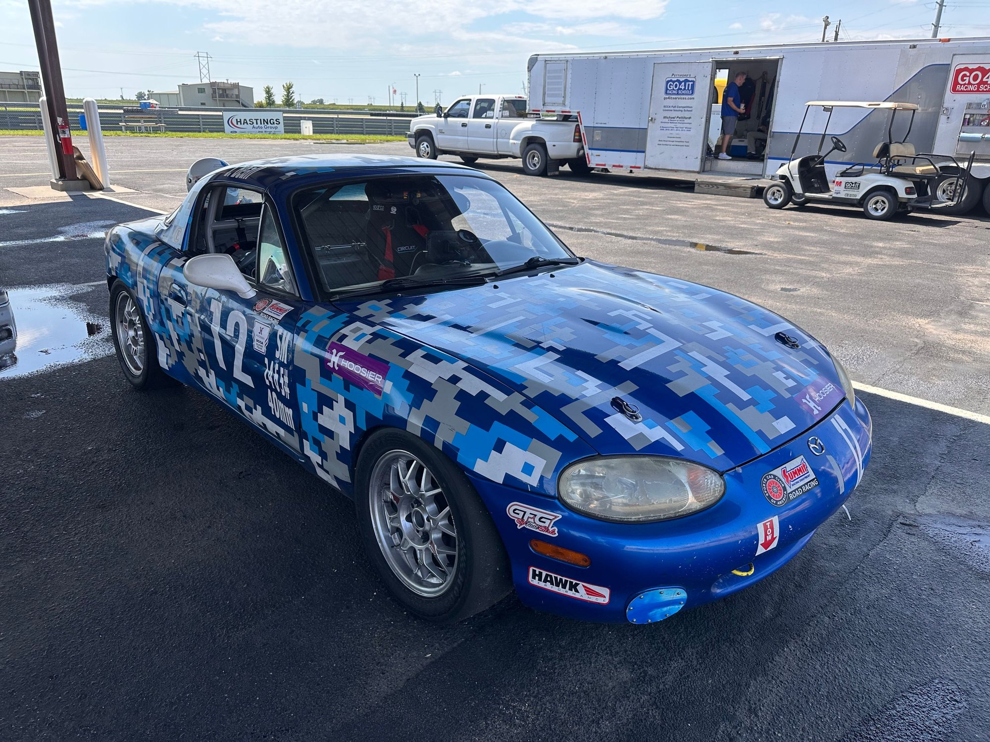

Soooooo … Nebraska … another adventure (all apologies for the long thread)…
Let the adventure begin … Planned to leave Thursday morning but needed to get my truck to the shop that replaced my transmission for a 1000mile checkup … I had some rough/hard shifts from the Ozarks trip that I made the service writer aware of and it wasnt a big deal and they were going to scan the software and check updates. They couldnt get to it on Tuesday so I dropped it off on Wednesday morning … Around 10am, I get a call from the shop saying that a brake line burst and that the tech was pulled over.
I live in a relatively large suburb of denver and coincidently I did see the tech driving my truck while doing some morning errands … including when he was pulled over with the brake line issue. Figured he was scanning the TCM/ECU
I didnt make a big deal out of it and happy it burst on tech and not while I was towing but I suspect he was left-foot braking to build boost and load on the engine and transmission to replicate my feedback on the hard shifts. But I dont know this for 1000% certain but it does make sense. I turn around and go check in with the tech and look over the truck. The shop had it towed back shortly there after.
But the anxiety builds in-that I dont have a tow vehicle and they have about 24hours to fix it before I have to get on the road. Scope turo for diesels or bigger trucks but nothing really looks like it’ll work. I message Mike Pettiford who is running in the race as well and he has an open spot on his trailer - I throw him some cash and he comes and gets the car and will drive it to Hastings and the wife & I will just drive her car.
We end up leaving Thursday afternoon and have a pretty good drive and arrive around 10pm that night.
Friday is a practice day and I hired Mike for driver coaching as it’s a new track and I want to be as prepared as possible. We have three really good sessions and I get a black / meatball flag for some oil-burning smoke. I know it’s something goofy because it only occurs after three pretty sharp left-hand turns. Black flag and they tell me I went four-off and didnt come in (which I did not, reviewed video and everything) but the burning oil was a bigger issue. One of Mike’s buddies is racing and is doing practice with us and he instantly said it was the PCV valve. So, pulled the value and of-course it was essentailly useless. I was able to track-down a full-aluminum replacement and some new hose and was able to get it fixed that afternoon … but I ended up not being able to run the last two sessions of practice.
I was pleased with the practice session and went into Saturday’s qualifying with great confidence. Qualifying went extremely well… My times started a little high but they dropped considerably. I ended up qualifying 3rd out of 4 spec miatas and only missing 2nd by .6seconds … the guy who qualified first was very good and very fast - I believe he has been running spec miata for 6 years.
Fast forward, Saturday’s race was pretty ****-poor … I didnt do well and I couldnt keep pace with 2nd place and fell behind by a half lap after the 20minute session. Pretty disappointing after such a good practice day and qualifying session … But, in the grand scheme of things, I still got points (gained one point on my lead with the guy who finished 4th) didnt wreck the car, didnt pop the engine and the new PCV valve fixed the issue.
Spent the rest of Satuday night reprograming my mental driving line, reviewed my videos with Mike and just let myself have a bad race and hit the reset button.
Sunday morning - a corvette blew a transmission line and put down ATF on about 2/3rds of the track … track shut down for 30minutes and there were portions of the track that were slick.
No one re-qualified for Sunday … it was essentially pointless as we all turned faster laps in the race. So Sunday’s race started the same way … I did substantially better for the first half and was keeping pace with 2nd place depsite over-driving the car. But around halfway I started to fall behind a few car-lenths on each lap. At the time it didnt 100% matter because I was solidly in 3rd place and I had 15minutes or so of racing. I just told myself to run the lines, dont over drive and dont take dumb risks and you can sit on 3rd place and add another point …
but thats where things start falling apart … there was a bad interaction with both myself and the 4th place driver where a spec racer ford pushed myself and 4th place off the track on turn 13 … I did go 4 off but was able to keep the car straight, recovered and got back on the track. 4th place also went off, I think spun, but was able to get back on the track as well… it sorted jaunted my confidence.
In the last 5 or 6 laps the 4th place driver caught me and stayed with me and passed me on the last lap … it was sooooooo disheartening … we chatted afterwards and he said either he was going to spin-out or was going to take 3rd place.
A few fatal flaws that came of this …
I missed 2nd to 3rd gear 3 or 4 times on turn 13 (last turn of the track) and it probably cost me 1 to 2 seconds by the time I got to turn 1. Not 100% sure why it wasnt going into gear (aside from operator error).
4th place did give me some very ‘stand-up’ advice (that could very well cost him places) in-that when I am waiving faster cars (such as the spec racer fords) I am lifting for a fraction of a second to let me have a clean pass. He said he could noticeable see me slow down and he could see that he was gaining on me. Such a foolish mistake… so, I will happily point faster cars but but I wont lift … which shouldnt be an issue with those higher power:weight cars.
My tires were under-inflated for the entire weekend (more on this later) … but it definately cost me time and speed.
I dont think it really mattered but I ran 87octane fuel for the entire weekend. Compression is 10.5:1 on the SM engines and I dont think it mattered, I didnt get any CELs for knock.
Overall disappointing but Im still in 1st place for points but will need a good showing at High Plains Raceway.
I did get excessively hot and felt nauscious after the first race … so, I will be picking up a cool-suit and I’ll install a water bottle this week.
some pics:

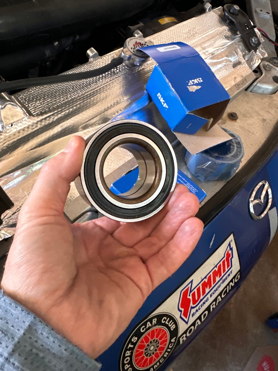

I did clean, relubricate, and re-boot both rear axles / both inner & outer boots, and put new bearings in the rear wheels prior to the Nebraska weekend. Was actually a fun maintenance operation.
Further maintenance (after Nebraska) I removed and cleaned my injectors … I am getting a small discrepancy between injectors where one is flowing about 12% less than the highest one and one is flowing about 6% less. So I got a new/used set of OEM injectors coming and I will flow test them as well and take the four injectors that are closest matched. For now, I put the two least flowing injectors on cylinders 1 and 4, which get less air than 2 and 3.
