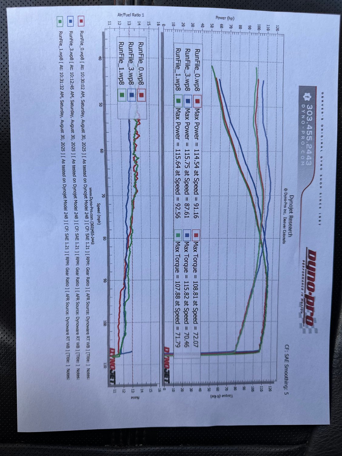

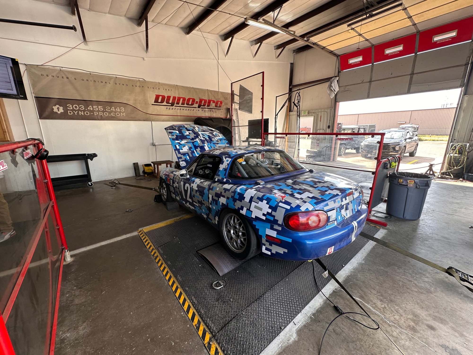

So, as mentioned above, got on the rollers and I thought I would be around 100hp (and maybe I am when you back the correction factor down to 12% to 15%). I believe I am down on power compared to my competition … the father/son combo both have daily driver miatas and are very experienced with the platform and tuning, I suspect they tuned their SMs for a little more power/torque…not 100% sure but I will be ready to go next season.
Once the spring rolls around I will get the car back on the dyno and push timing and dial-in AFRs (to the extent that SCCA permits). I was encouraged to see the 115hp on the dyno and calmed my conspiracy theories.
For what it’s worth, XFactor (engine builder) did not optimize timing (verified with a timing light using mazda’s diagnostic technique to determine base timing was set to 10degrees) and got fuel pressure dialed-in close enough but it is likely .5 to 1.2 points rich … and running a little leaner will yeild a few more horsepower… I purchased Flyin Miata’s adjustable crank timing wheel and then went and designed one in fusion that has a little more range than FM’s 4degree advance. More to come
