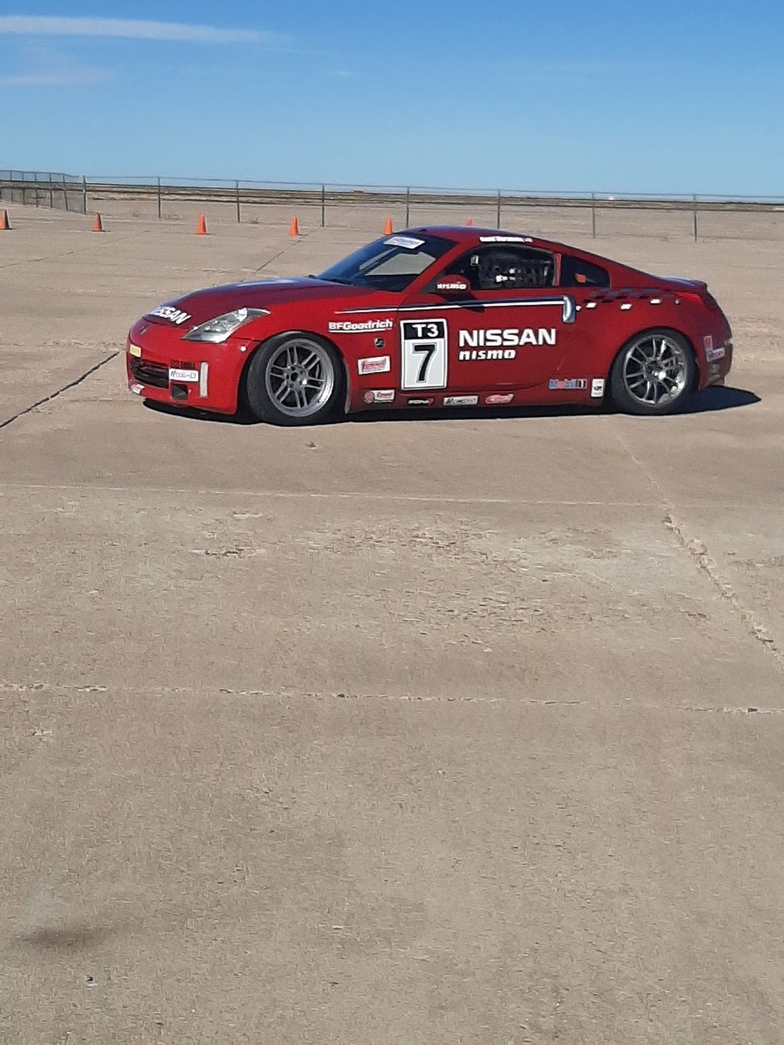

Just posting a pic to offer some contrast to the doom and gloom photos in this thread!

But the news on the Touring 3 Z has been better, and after exhaustive diagnostic work, it's back up and running! A lot of rewiring work by our local Nissan guru, Allen ***, repaired some internal shorts in the main wiring harness. This required his particular expertise in tracking down exactly where to replace certain parts of the harness and test them. The Z finished third in the last Majors race in RMDiv in the hands of Ian Sullivan (who I'm sponsoring this season) and I'll be entering it at the American Road Race of Champions (ARRC) at Road Atlanta to get at least one race in this season.
