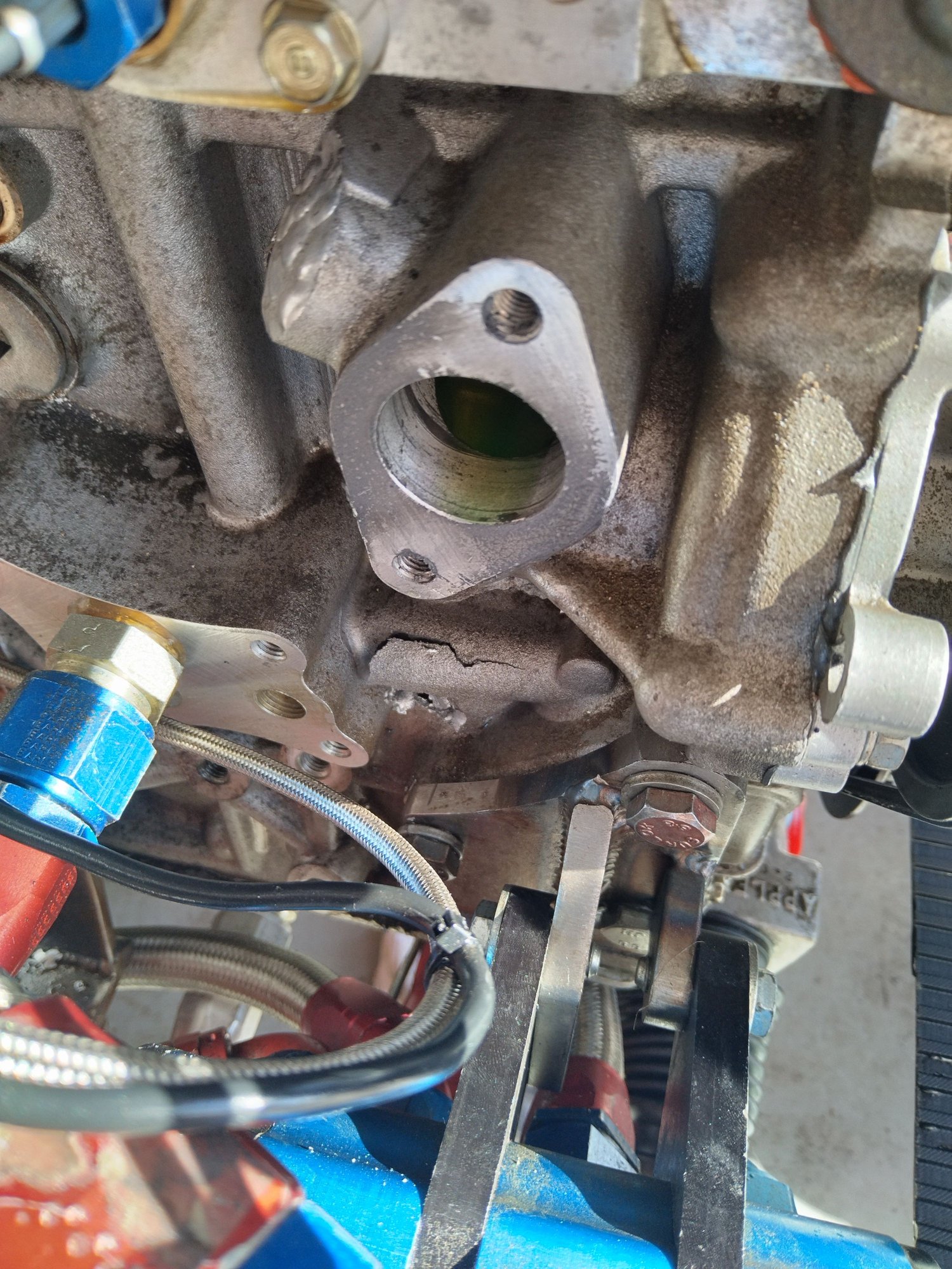

Sorry to report that my opening race has resulted in a catastrophic engine failure. It started with a stone that damaged the oil cooler for the SR20VE. After installing a spare, we were forced to start from the back of the field for the opening SCCA race. Readings were nominal on the warmup lap, but after the green flag fell, as we headed into the long uphill first turn the engine tightened up and then quit. Dropped the clutch and got off the line as quickly as I could. But I could already feel my tires were feeling slippery. Waited till the end of the race to get towed in and initial inspection looks like a rod failure on #1.
With no spare available, I'm currently weighing what options I have for the future. More photos after the teardown.

The SR20VE was a fresh build several years ago. With JE high-dome pistons, Eagle rods and ARP hardware, it seemed to be in pretty good condition. But all it takes is a momentary loss of Mobil 1 lubrication to cause serious damage. We'll pull the head later this week and get a better idea of how bad it is.

Was it a spun bearing (rod failure)? Do you think the anything is salvagable? Do you build your own engines or have a shop do them?

The engine teardown is going to take some time, but a spun bearing is a possibility. Can't rule out a materials failure of some type until we take a closer look. Car is currently in my garage and will take some time to get the shortblock up onto an engine stand. But initial inspection shows the drysump pan and most of the block look intact.
This particular engine was built at BMF Performance in Brighton about 15 years ago. They did the port and polishing of the head and other skilled tasks, while I did part of the assembly, so I know who to blame if it turns out to be any build failures...

Teardown tonight stopped when I realized I'd lost the 12-point 13mm socket needed to pull the ARP nuts off the head studs. Look carefully and you'll see the windowed block under the water port. There may be more damage to the drysump pan, and #1 and #4 plugs were badly damaged. The horror show goes on...
