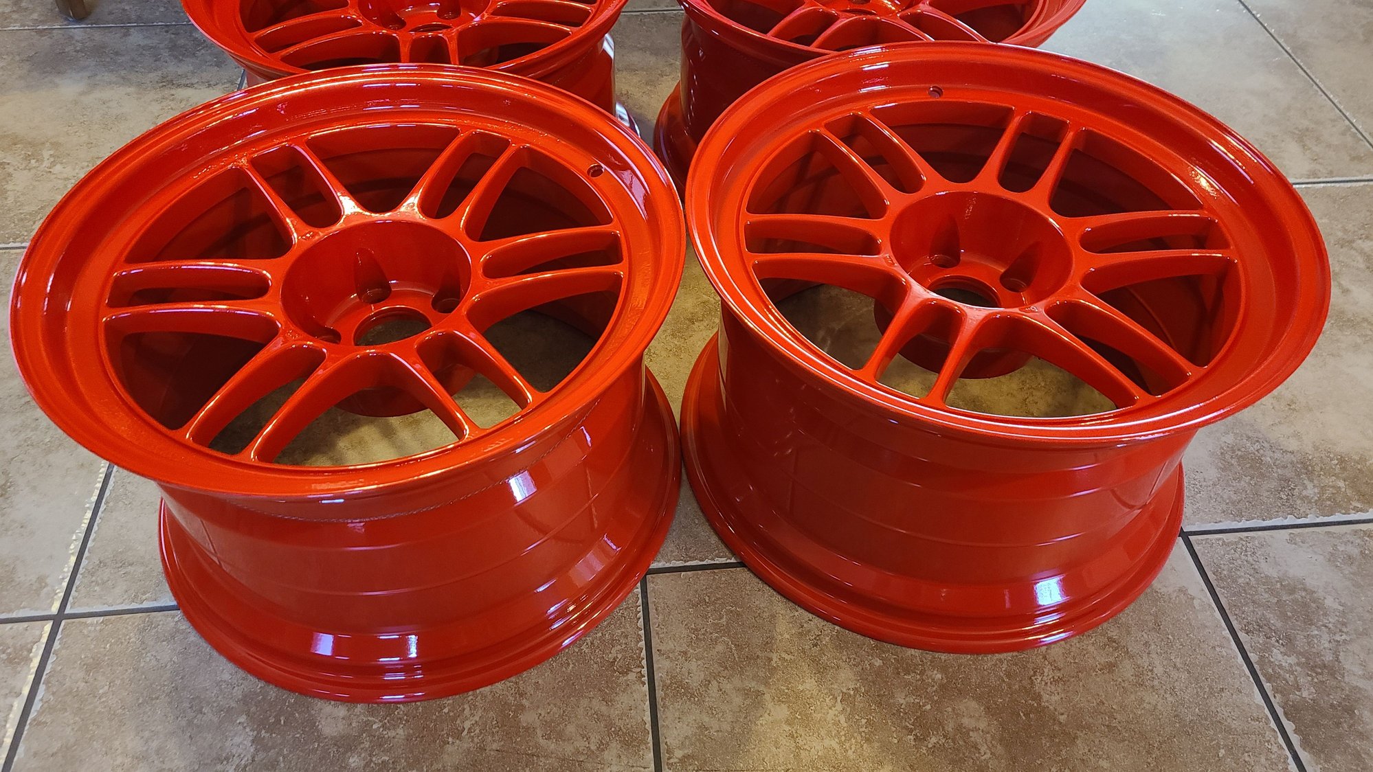

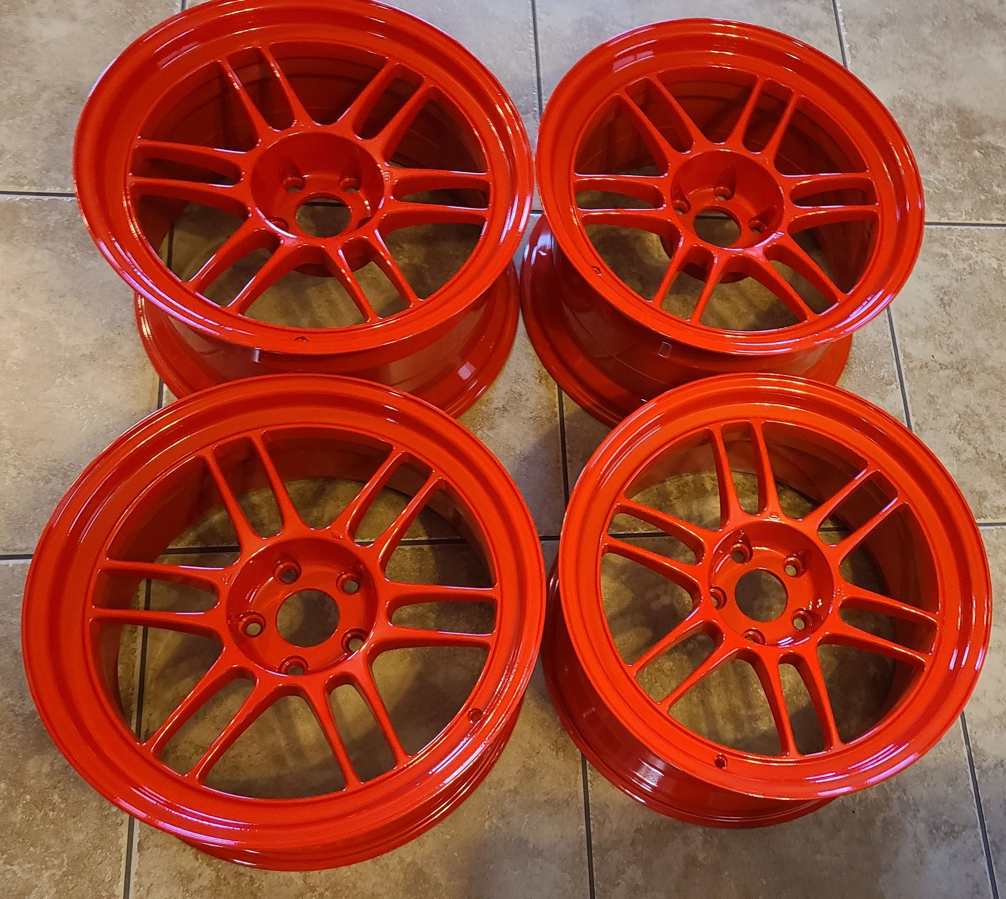

I got the Enkei RPF1 wheels back from the powder coating shop. The Brembo calipers needed a redo on one of them so they still have them but the wheels turned out great. I chose this color because I'm going to have the car painted white to match the Cayman. and the hood and hatch are CF so it's not going to be a huge paint job.

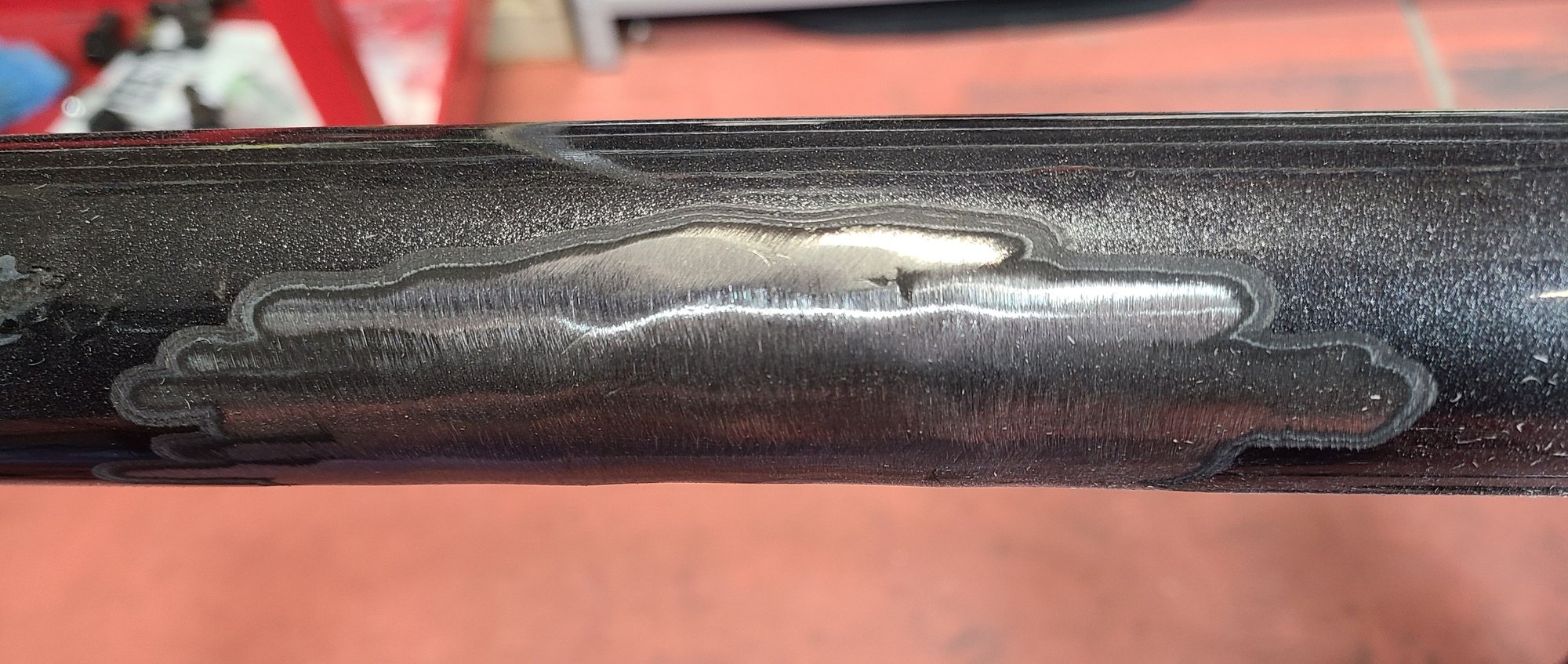

been fighting with the roll bar to get it to fit and it's not cooperating. seems like this Kirk is a p i t a but it saved me from buying another one so I'm dealing with it. I did a test fit of the seat with helmet on and with the sliders removed the stock Corbeau brackets leave barely enough room and I'm 6 ft tall. it'll work without the sliders but I'll have to get used to it.
