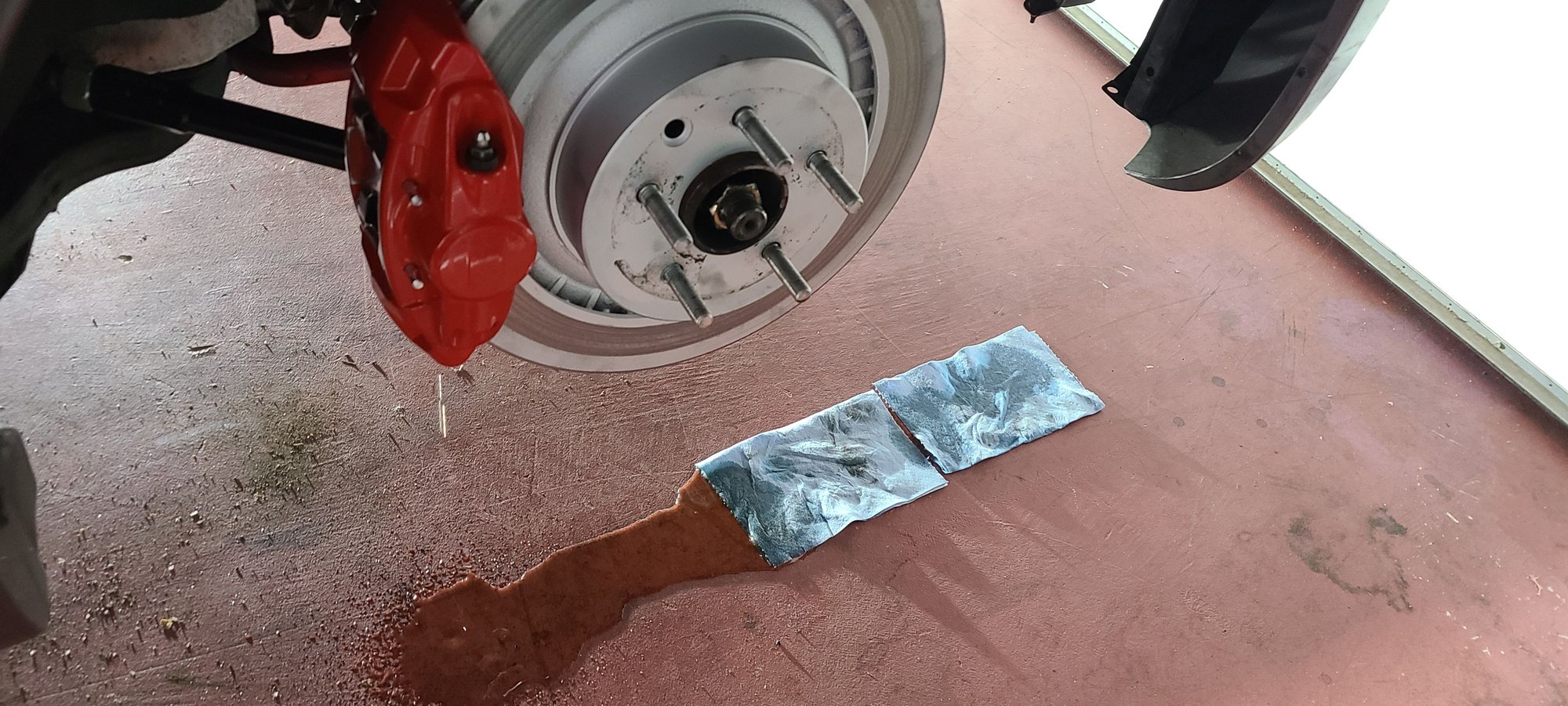

FAIL... Rear calipers need to be rebuilt. I suspected when assembling... it was foolish to not use all new gaskets but suppliers are all out of centric stock. this is what happens when you try to do too much at once... going to put the OEM rears back on for now.

it's not that rebuild seal kits aren't available, it's that the OEM kits are $80 from Nissan and a reman caliper is basically the price of that rebuilt kit which is queer as far as a supply chain matter. The centric kits are impossible to find I don't know why the hell that is a problem it's just rubber.
​​​​​oh ****. I was going to put in the order for three different rebuilt seal kits because they're only $6 and they'll take 3 to 4 weeks to ship and I thought okay well I'll use a new set of reman calipers until these kits come in and see if I can restore my current set of rear calipers.... and I just realized.... they're worth more as a core than as a usable rear caliper.
damn this situation really sucks but I'm not complaining because these are a great value for very low cost. I'm guessing @Dr Hoon had the same issue recently. rebuild or new? there are no centric rebuild kits anywhere and the Nissan OEMs are the price of a caliper.
The irony is kind of funny really because these calipers should be two to three times the price but they are really damn cheap.
I even feel stupid now for paying $400 for the two fronts even though they were new. NOS I think. but the reman calipers are $180 for the pair. powder coated.
so it would be a waste of time to rebuild the rears that I just bought and got powder coated damn it!! when they're worth more as a core return for $88.
there comes a time in a track car project when you have to stop min/maxing and just get it done...
