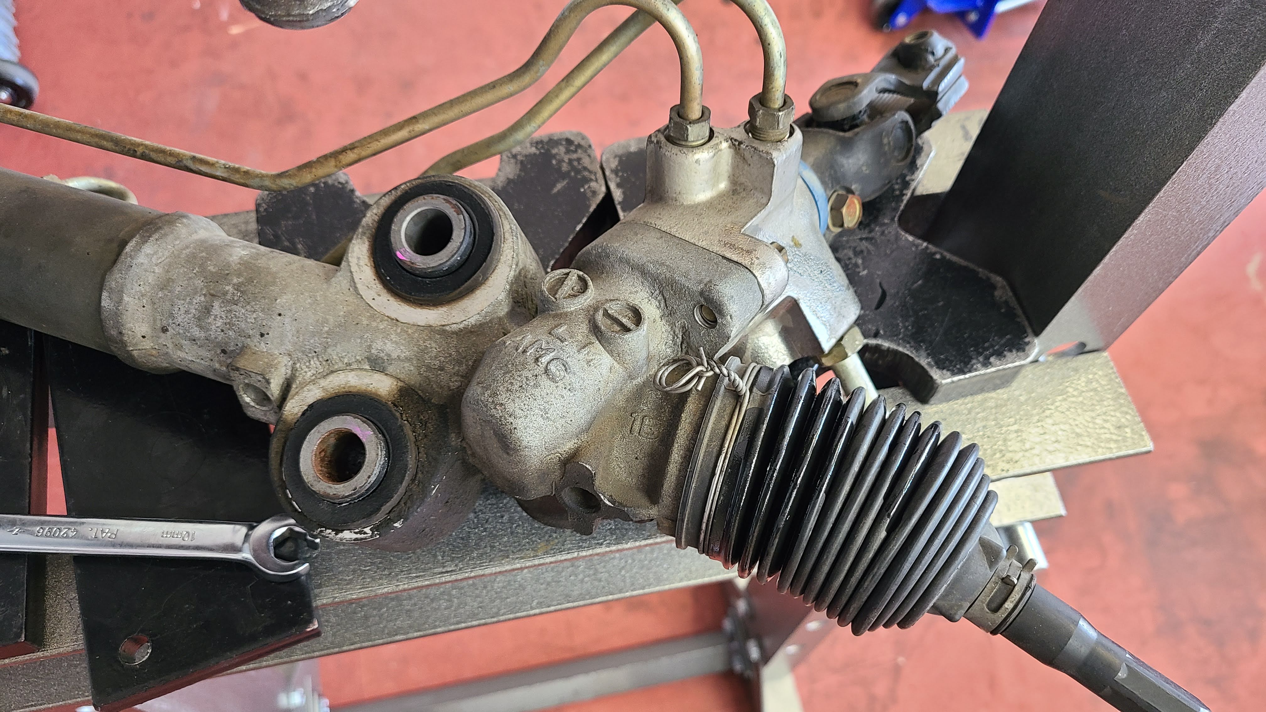

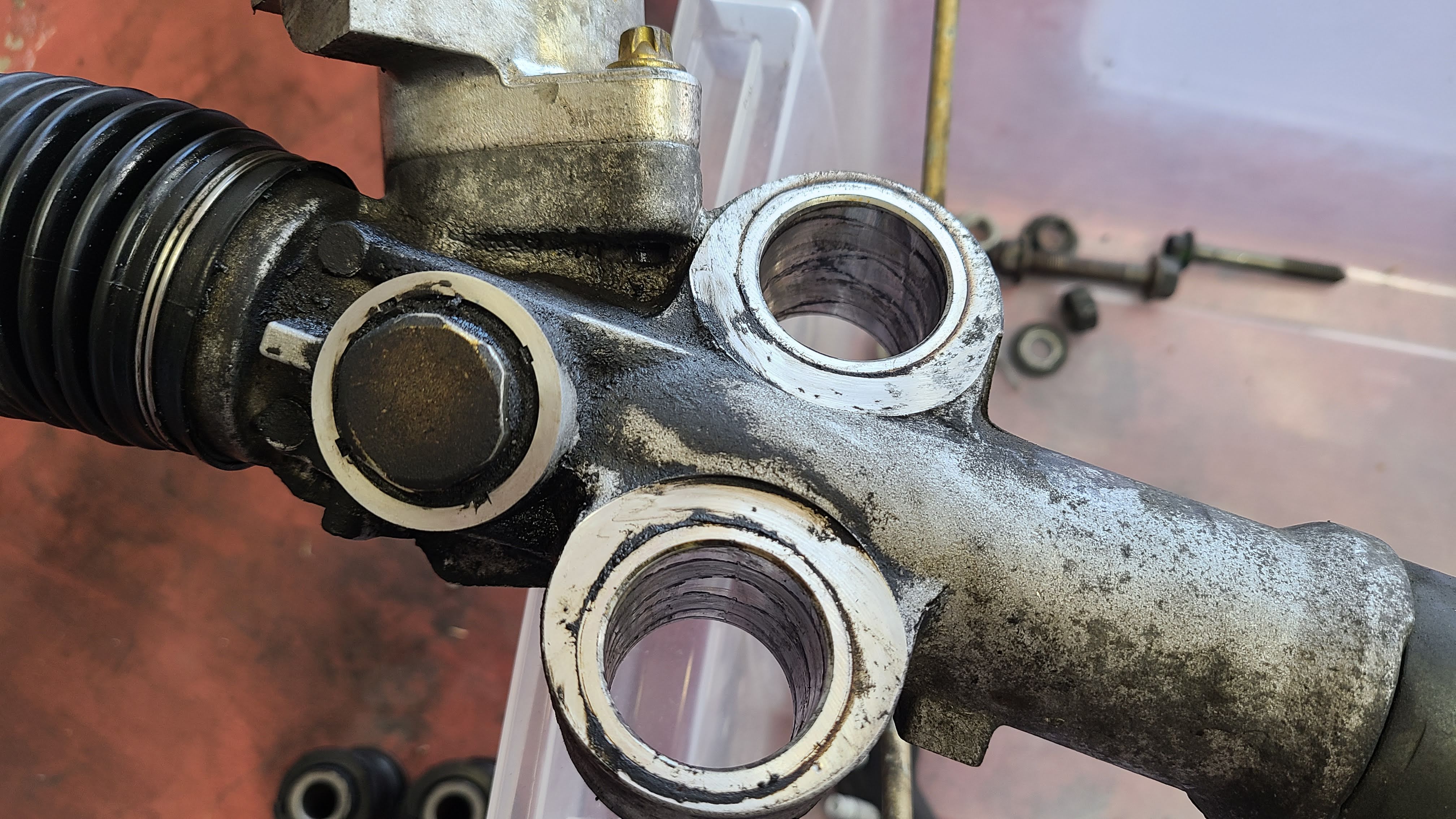

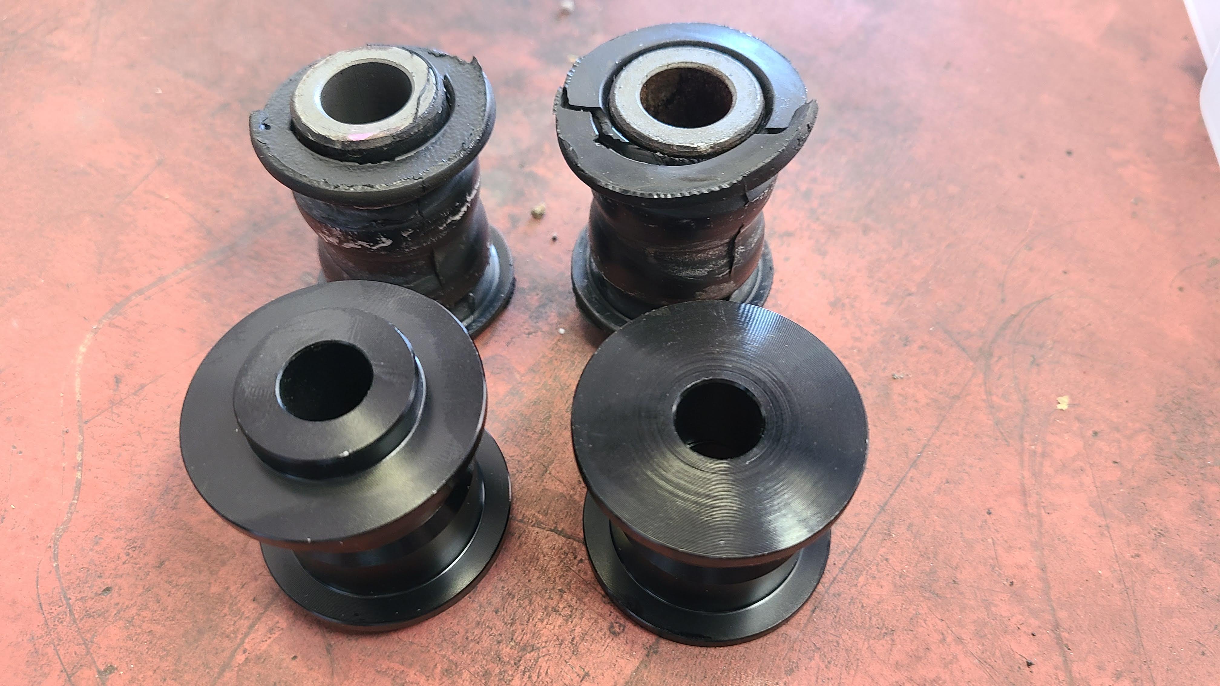

Today (so far) I installed a set of GKTech solid steering rack bushings, because I already had the front end disassembled and it was convenient. I like the quality of GKTech's stuff. I've got a few more GKTech parts to install this weekend. I think the car might be back on its wheels in a few days after sitting on jackstands for 7 mos.
I'm sort of obsessed with bushings now... it's the first thing I look at in any car. I usually start with wheels/tires because suspension and brakes need to work around wheels, but I really nerd out with the bushings. Some cars don't handle solid aluminum bushings as well as others. Poly 75D is basically as hard as a bowling ball, which might as well be solid but it does give a little bit--enough to not stress some cars with less than robust frames. It's too bad there isn't more 75D poly available for the 350Z. I'm obsessed with solid bushings but 75D gives similar results. Maybe it's more expensive than aluminum? I don't know, I just ran across it when exploring bushings for other cars.
In these photos I pressed out the old bushings and installed the new ones from GKTech. This is honestly not an upgrade I would have thought to do had I not run across the part on their website. Interesting. I really don't know if solid will improve steering but I'll find out soon.
