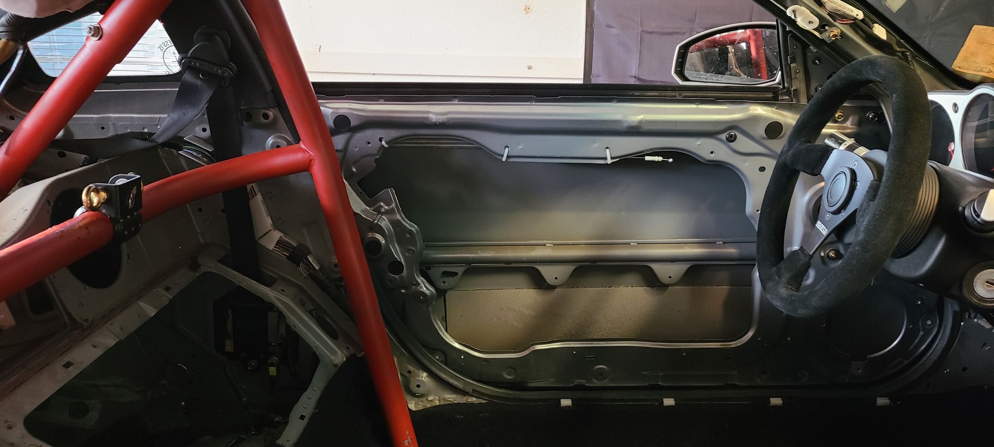

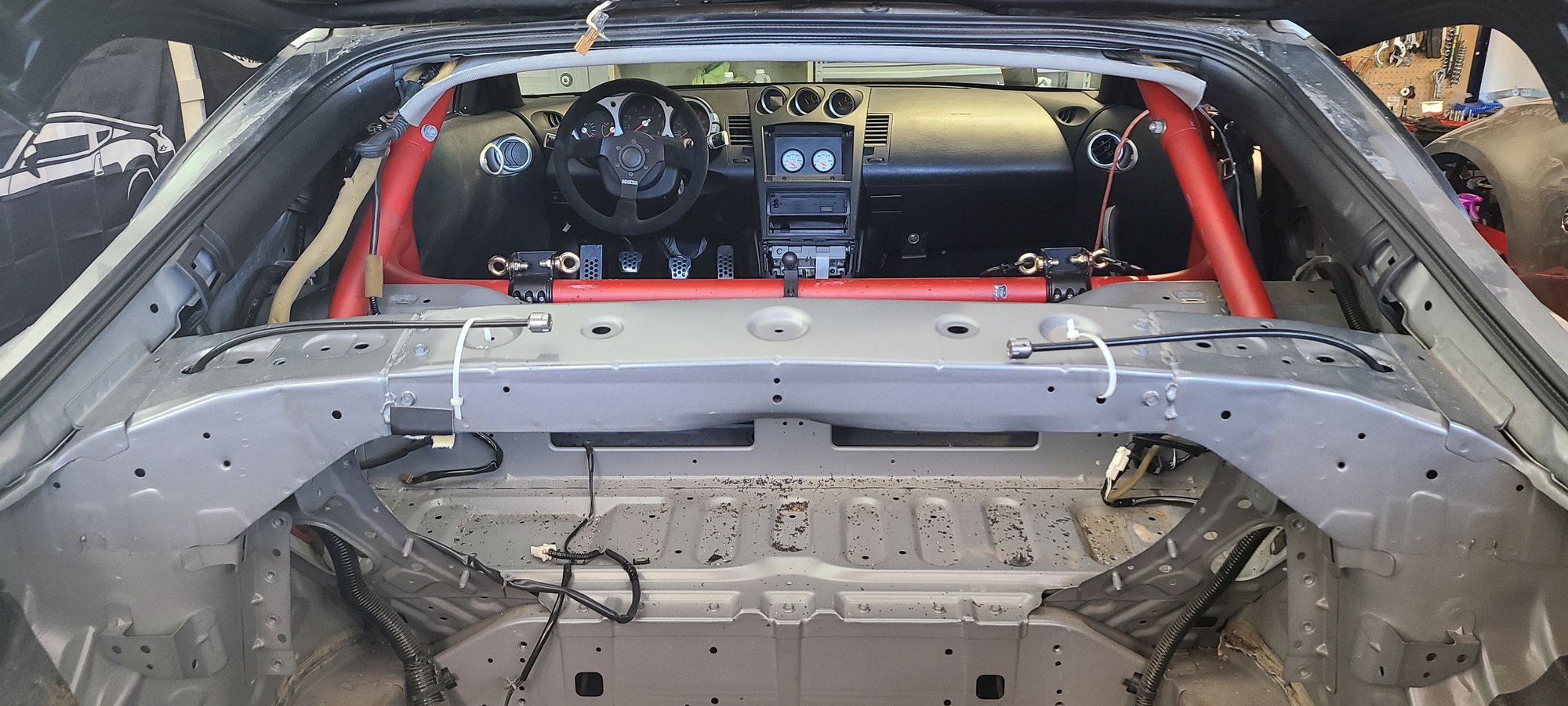

first round of attacking the interior today for the first time. I'm trying to do this without removing the roll bar. I'm aware of how difficult the floors are and plan to leave the carpet in place for now. I am going to cut open the rear shock supports and get rid of those extensions. I intended to shorten them at least, but I'll just open access to the top.

Hoon, I recall you replaced your door windows with Lexan. I just removed everything. it was surprising how much weight was removed from each door. and probably a pound of hardware alone. I think it's an easy 20 lb per door removed. The doors feel so light now. I love it. did the same thing with the Z3.
I don't think I'm going to have any trouble hitting 2,800 lbs.

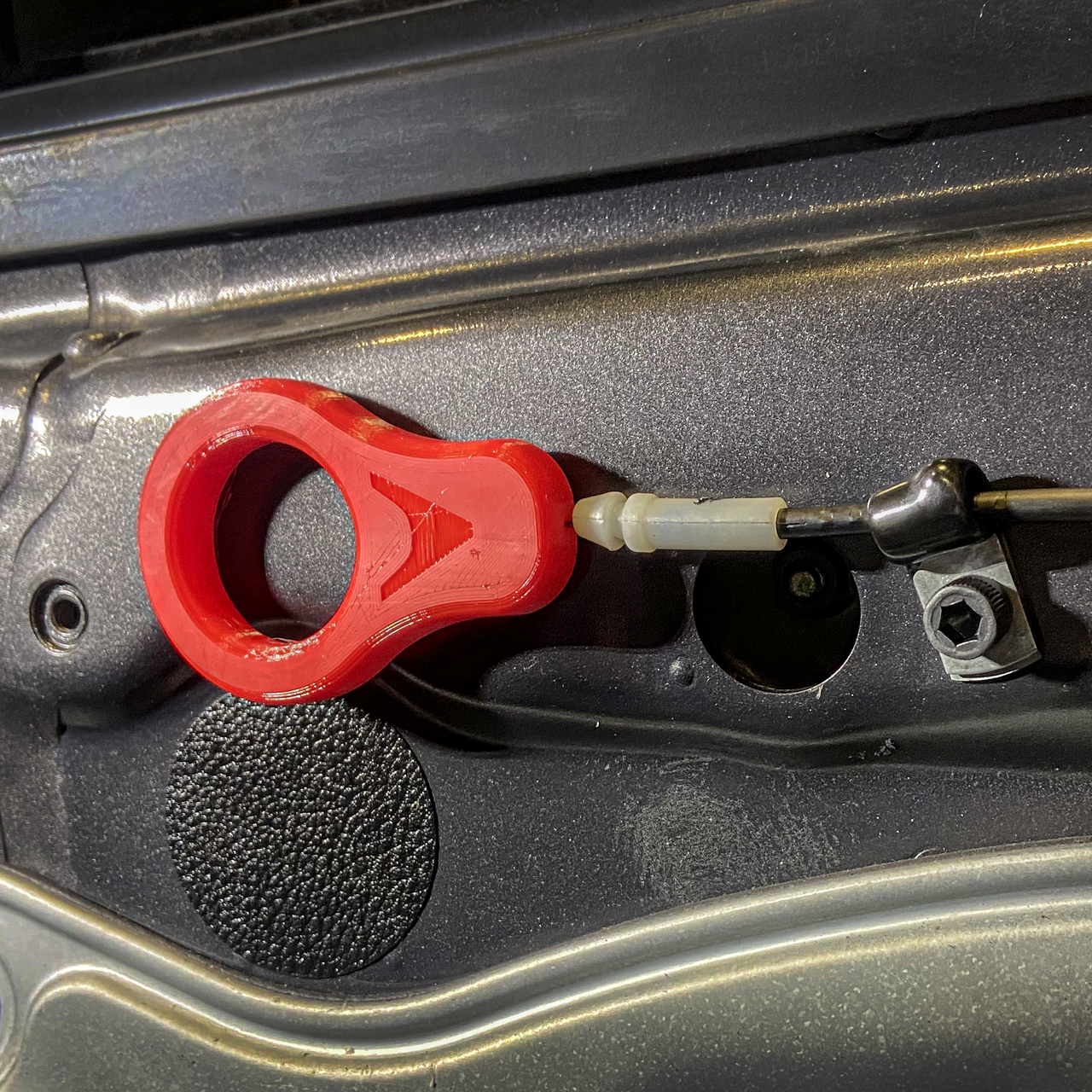

I zip tied the interior latch pull wire although it's just as easy to reach over and pull the outside handle. You can see the tip peeking out in this photo.
Enjuku has these pull rings that attach to the ball on the end of the wire. a little more convenient.

The moral of this story is, I need a 3D printer. 😄
