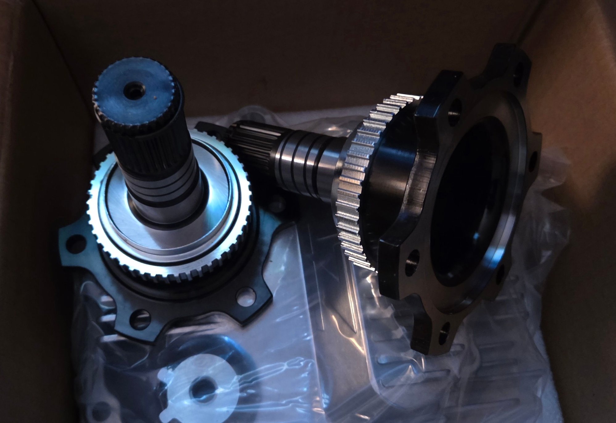

Axle stubs arrived. I think getting this put together and installed will motivate me to get other stuff done that I have neglected to do.

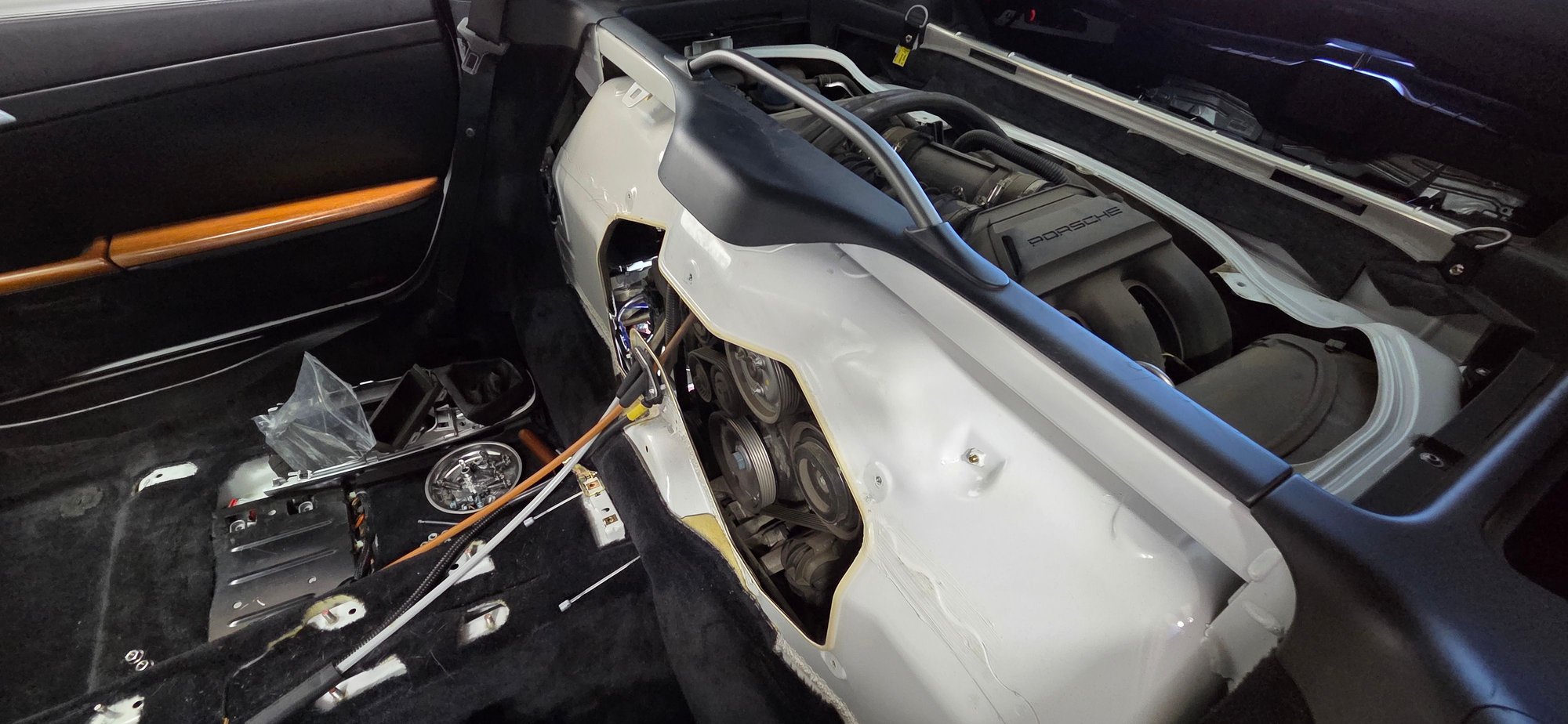

not yet, but it's assembled and ready to go into the '04. I've been remodeling the house for the past year and just recently cut back on my work hours. so between the contracting and working too much, the cars have just been sitting for a long time. I've got the shift cables out of the Cayman, getting the numerics installed. that was not a fun job. I figured out that on the driver side, it's way easier to go through the top. I took the MAF tube and TB out. and the driver side shift attachment is right there. super easy at that point. whereas getting to it from the wheel well seemed almost impossible to me... and while I had it apart I ordered an IPD intake with the 82 mm TB. which just arrived today so I can put this stuff together this weekend so I can get the Cayman out of the way and install the MaxJax. it'll be so nice to get the Z on the lift.

Lots of delays... while I had the plenums removed, I decided to buy the IPD 82mm plenum + TB and yanked out the two butterfly valve vacuum tubes by not paying close attention... I figured when you pull on a vacuum line, it pops off, but instead it came out of its source under the intake. an honest but stupid mistake. so I've got my worm camera searching for the 1/8 vacuum line attachments for both the front and rear plenums. This is shitty engineering. leaving a vacuum line just attached by friction is stupid. anyway I haven't found them yet. I've scoured forums and diagrams and the usual suspects are not what these are attached to.
I don't regret doing this because I've wanted to install an IPD plenum and it will be cool to get this done but I feel dumb for manhandling the tubes.
at this point, I'm really behind schedule. I've got a MaxJax waiting to be installed and a buyer for my 03 350Z. so I need to get this **** done already...
there are so many times when I wish I had a buddy nearby to point out obvious mistakes... I do have a friend at a local shop who works too many hours but if I could get him to come over and help me with a few things it would get me out of this rut...
I've got the shift cables wrapped and attached to the transaxle so this is really close to being done. I just need to find the vacuum attachments. and I don't want to take the whole intake off in order to find them...
