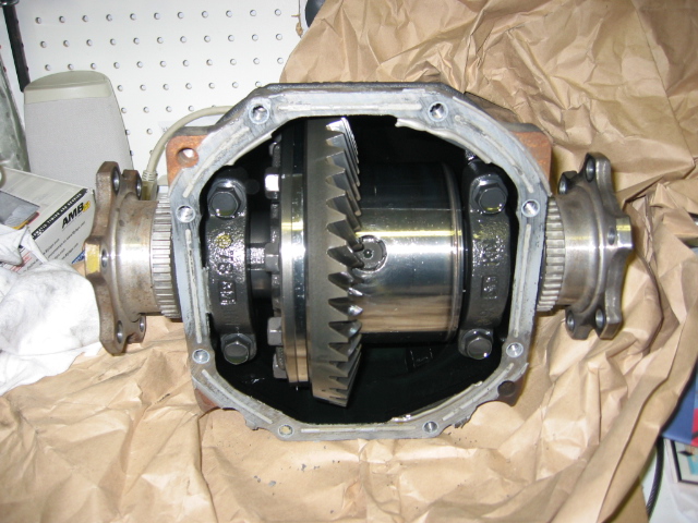

Hey man, I may be wrong, but the 2nd pic in your #4 post looks like the diff is set up 1way.
The shaft that supports the spider gears has a flat side and a round side. In a 1.5way the flat sets against the sloped edge of the side plates and the round side sets against the flat edge of the side plates (the notches the spider gear shaft sets in)......lots of spreading under accel and some spreading under decel.
Your pic looks like the round edge is against the slope and the flat edge is against the flat part of the notch.....no spreading (plate friction) under decel.
I only noticed it b/c I just finished setting up my new cusco rs for install......1.5way, 80%
mike
edit for pic

You're making me nervous here. This is a picture of what it looked like when I took it off of the car. It is set up as a 1.5 way from the factory. I don't think the pin is reversable in the nismo because it houses the break away torque setting adjustor. I believe the way it works under decel is that only one side of the clutch pack is activated, hence the half strength under decel. It worked that way when I moved it by hand while it was apart.
Also curious what cusco considers to be 80%. I'm assuming it's 7 out of 9 friction surfaces, or the way I had mine set the first time aroune.
edit: if you look closely at the picture below, you will see that the notches are separated from each other and contact the pin at the rounded portion. The cusco has the flat portion of the notch touching the flat portion of the pin, hence no outward force, or locking)

I didn't mean to make you nervous......It just looked different from what I expected since cusco makes the nismo.(I think) I see what you mean in your edit. The side plates in a nismo are farther apart and contact the rounded edges of the pin, not the flat.
The cusco has 10 plates on each side (like yours) so the adjustment should be the same. The order for 100%.......TsTsTsTsTs
80%.......TsTsTsTTss
I'm curious......Does the breakaway adjustment preload the clutch stacks from the outside of one of the spider gears? The cusco has small springs between the two halves that sets the preload. I'm wondering if changing those springs would work the same as the nismo adjustment.
mike
