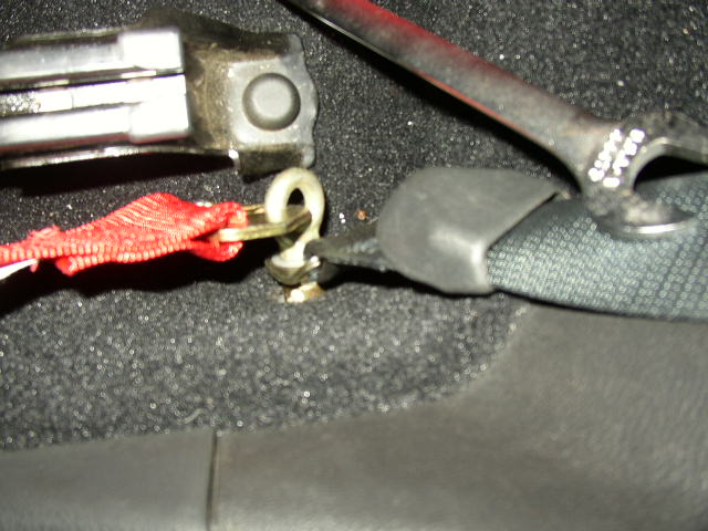

Tom, I had the same problem. I got 2) 7/16-20, 1 1/2" thread length eye bolts from Pegasus (800-688-6946). Part #2384. They thread in fine. I also picked up 2 jam nuts. This allowed me to maintain the stock lap/shoulder belt. I needed to buy a thin 11/16 open end wrench to tighten. Got that at Sears. I'll take pix later and post.

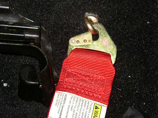

Almost forgot, PIX:

Here is a shot of the inner mount:

Sorry for the confusion. Only the outer bolts were replaced with the longer eye bolts. I drilled holes in the transmission tunnel for the inner eye bolts. I used the short eye bolts and nylock nuts that came with my Schroth belts.
I do not recommend using the seat track mounting points for any belt attachment. Some racing organizations require them to be separate.
