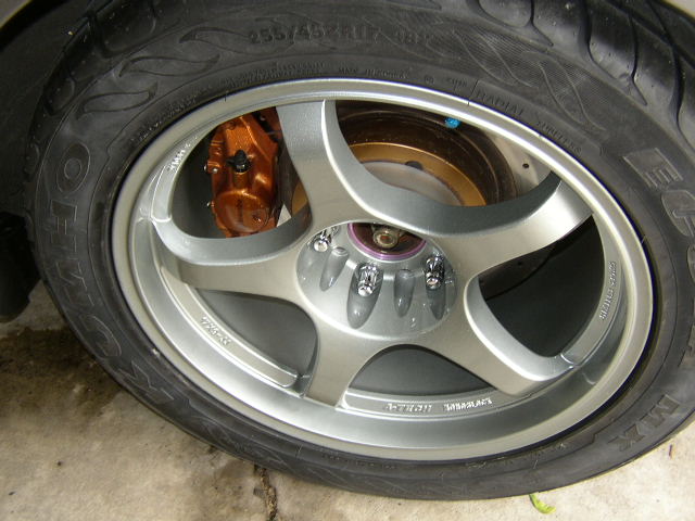

I now have his rear brakes....Not quite Hershey brown, but noticeably darker. Let me try an find a pix. His new 14" Stoptech caliper lettering has turned from white to cream!
Your pix sure make the caliper look REAL dark! I guess I have to brake harder!!!!!
I think my front hats turning from black to a brownish purple is pretty cool too!
Not sure why the different sides are changing at different rates.
