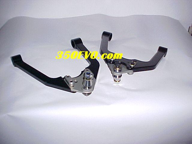

John, how did you get that much front camber? Just from running the car lower on the coilovers?
I'm anxiously awaiting the camber arms from BJ since I'm completely stock right now and have about -0.80 degrees in front. This is not good for my hoosiers! I don't want to lower the car because I won't be able to drive around in Manhattan anymore if the car is any lower, so that's why I'm going with the adjustable arms. Plus, I like the stock look.
I figure that once I get the a-arms I'll go to about -2.5 in front. At the rear, I'm at about -1.8 (stock).
Old Jun 10, 2004 | 02:17 PM
Jason Bourne's Avatar
Jason Bourne
Posts: 407
From: NY, NY
BJ - Stop taunting me... When can I get them?
