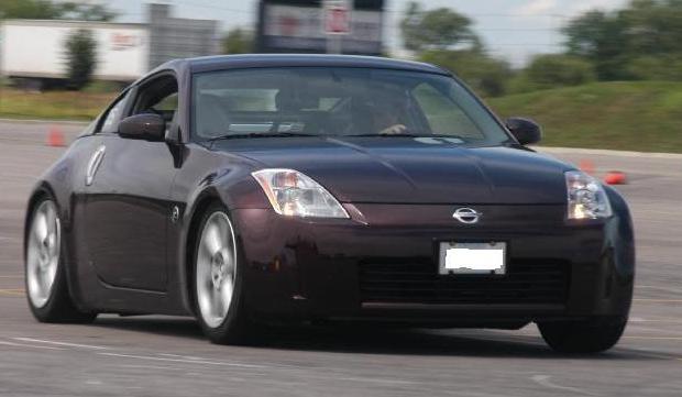

I've attached a pic of my AutoX this past Sunday at the Corel Centre. As you can see, the spacers work well even with the drop - but I wouldn't go wider.
When I run the 17x9s I'll definitely be unbolting the spacer off the hub (spacer doesn't use longer studs, it has it's own built-in offsetting studs which the OEM rim bolts onto). While I'm doing it, I might slide on a 5mm spacer onto the OEM studs before mounting the AutoX wheels.
