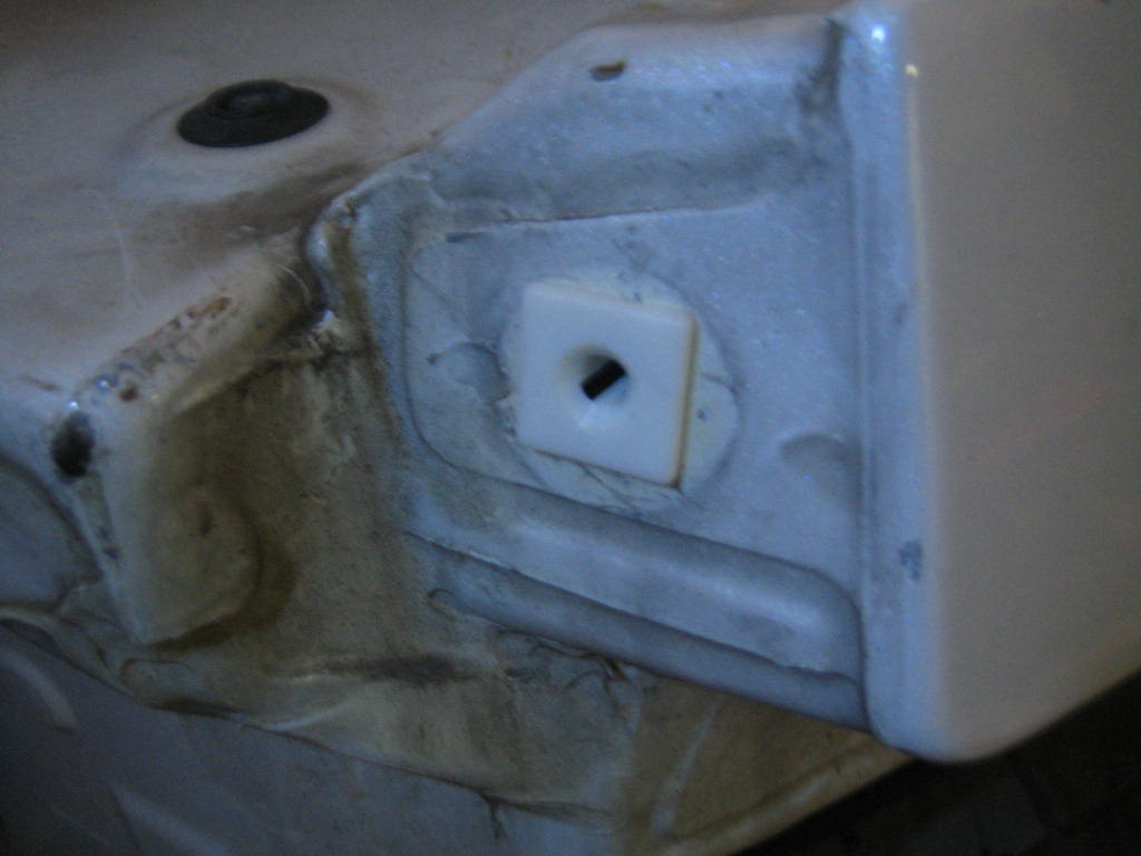

Originally Posted by usmanasif
IMPORTANT: There is no such thing as an "automatically unlocking" white clip. OP is exactly right, they do need to be turned 90 degrees to unlock. I removed my rear bumper last night and after removing all other screws and clips, tugged and pulled at those clips to no avail. When you do remove them, you will see why; unless the clip is aligned with the rectangular hole, there is no way it is coming out. Mathys, I think you got lucky there; perhaps they had both moved to an almost unlocked position from normal driving.
That said, they are hard to remove but not impossibly so. I missed OP's post about using a 10mm socket and did it an alternate way. Took a pair of pliers and stuck my whole hand into the hole left by the taillight (just enough room even for my giant hands). Then with the pliers facing up, I had just enough leverage to turn the clips. Good thing they don't require a lot of force. But yes, DO use a 10mm socket to turn them and you will have them out in a few seconds.
USMANASIF is exactly right...the clip isnt designed to be pulled out with force.....
To me the easiest way was with plyers - took me 5 seconds per side.....no lie...
STICK YOUR HAND IN THE OPENING AND ORIENT SOME SMALL PLYERS AT AN ANGLE AS SHOWN:
KEEP GOING:
AND GOING:
YOUR THERE - TOP VIEW - TURN DAMMN IT!
EASY BREEZY!............anyone with average sized hands should be able to do this....
If you dont have small plyers like i do, then of course do the same thing with an 8mm wrench:
pic shown to prove its 8mm
-J
