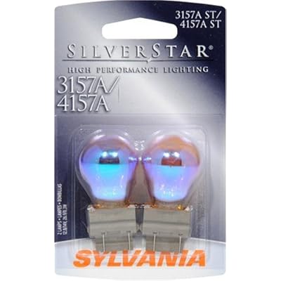

I did mine over the weekend. What takes the longest is letting the paint cure. I waited over night. I also primered first then painted on a few coats.
I didn't change my turn signal lights. I couldn't find any stores that had the above bulbs in stock. They didn't have them at Autozone, Pep Boys, or Kragen. I got a feeling though that the clerks were just too lazy to walk down the aisles and look for them. Instead they looked on their computer and that was that.
You guys should also change out your parking lights. The stock ones are yellow-white which is pretty ugly. I opted not to put that dimple clear plastic piece on nor the squarish shaped piece in front of the turn signal bulb. It was yellowish in color so I just said forget it. It's just a matter of if you like it or not.
One more thing, when you are putting the lights back together, it is going to be very difficult to not get silicone on the out surface of the headlight. I'm not sure if masking tape would survive 250 degree heat but if you guys try and it works, let the others know. In case you can't mask off the headlights, have some Windex handy and a microfiber towel. You can usually get the silicone off while the headlight is still warm from the baking. Just use some muscles.
