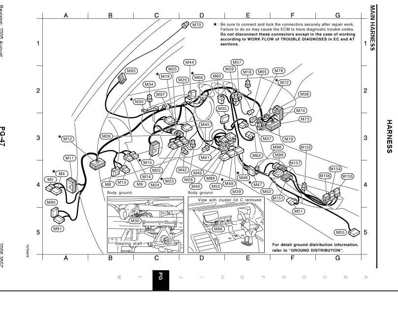

Ok I found some manuals but still don't know what wires are what.
The harness I have is the one that plugs into the heated seats switches. I think it is on PG-47 Of the factory service manual found on 350ztech Its plugs M154 M155 M151 M152 M157
Cant post the manual since it is really large file.

Took a screen shot and here it is
Attached Thumbnails Tutorial: Leather Power/Heated Seat Swap!-harness.jpg   Tutorial: Leather Power/Heated Seat Swap!-harness-chart.jpg

Posts: 329
From: Austin
You are looking at the wrong wiring diagram...you need the onen that traces each wire through the car. If I have time this week I'll see if I can find it for you; I know for a pact its in the service manual.
In the meantime, test those wires with a voltmeter. My guess would be white and red are power, green is control and black is ground. Not sure about the other two.
