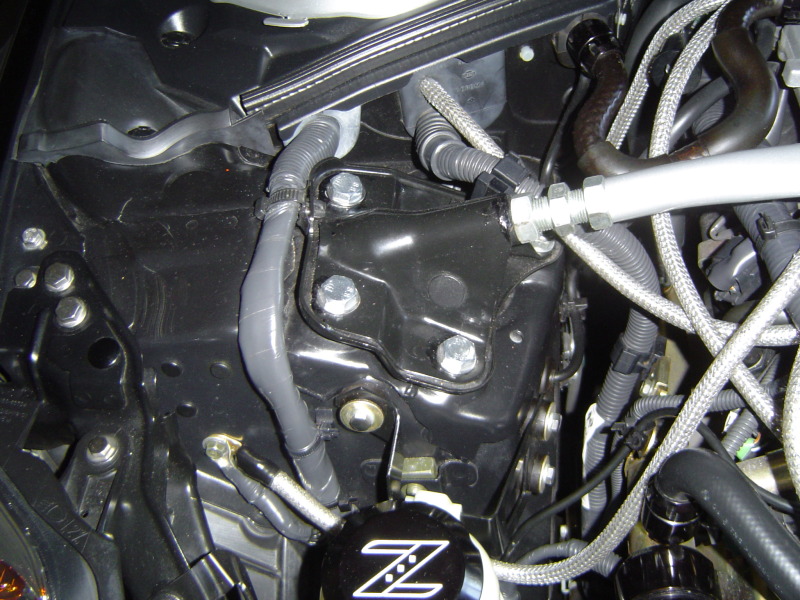

All I did was use the old fashion "elbow grease" using Nevrdull....works miracles!
What your seeing is oem strut bar bolts (originally crappy lookin') that now look like brand spanky new polished lustre to dazzle the eyes!!!!
