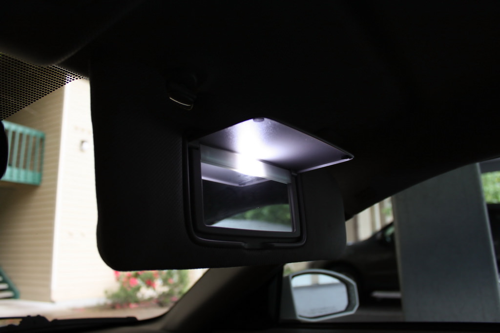

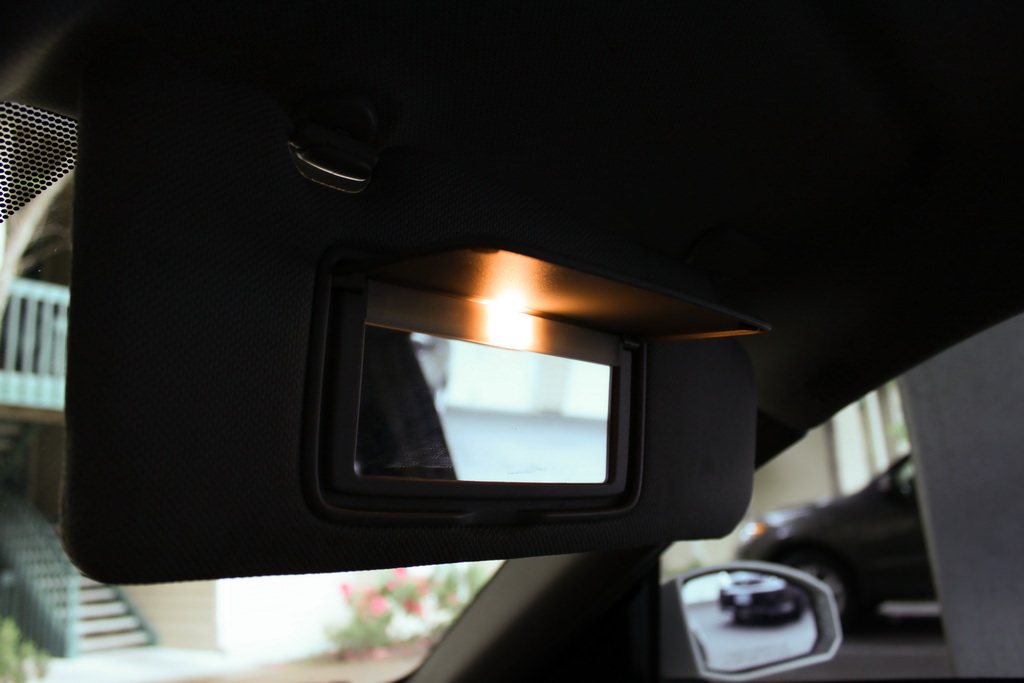

So i bought some bulbs after checking my own, i'll report back once they're fitted. No mods required hopefully.
Old Jun 8, 2012 | 06:52 PM
F2CMaDMaXX's Avatar
F2CMaDMaXX
Joined: Sep 2011
Posts: 1,751
From: Oregon from England
White 3-SMD 6641 - is the LED type fitment, it's a different bulb type for filament bulbs.

DIY: Vanity Mirror LED replacement under -ejnuuqp.jpg
DIY: Vanity Mirror LED replacement under -slgewov.jpg

Nice pics. How are they on the eyes? I was afraid the SMD ones would be too bright. Great pics. Too.

Originally Posted by F2CMaDMaXX
I honestly don't see why they would change at all, so i'll take a stab in the dark and say yes?
Here's the place i got them from, pretty fast shipping too.
http://www.ebay.com/itm/White-3-SMD-...#ht_610wt_1396
Just purchased 2 of them, one for each visor/mirror. These are pretty much replacements for the oem ones right?
Thanks, and no, the diffuser does a pretty good job so the light isn't too bright on the eyes.
