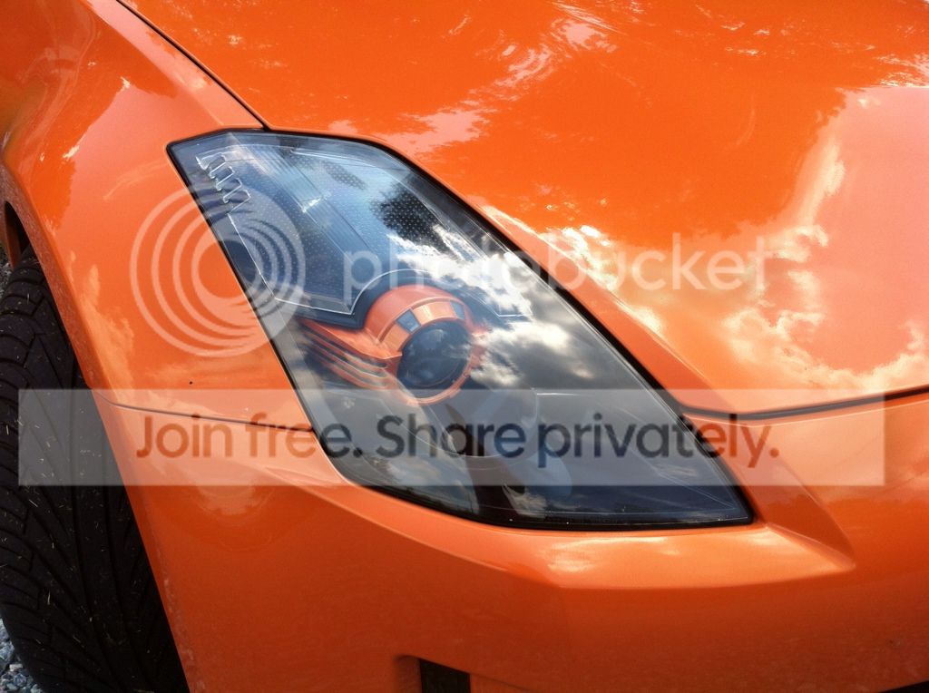

Here's how mine turned out! Thanks for all the help along the way!

Great job man
Glad to assist
.lose that 194 corner bulb tho
No need for it and it jumbles up your clean work.. just pull it n plug the bare harness back.in
.just a thought...
