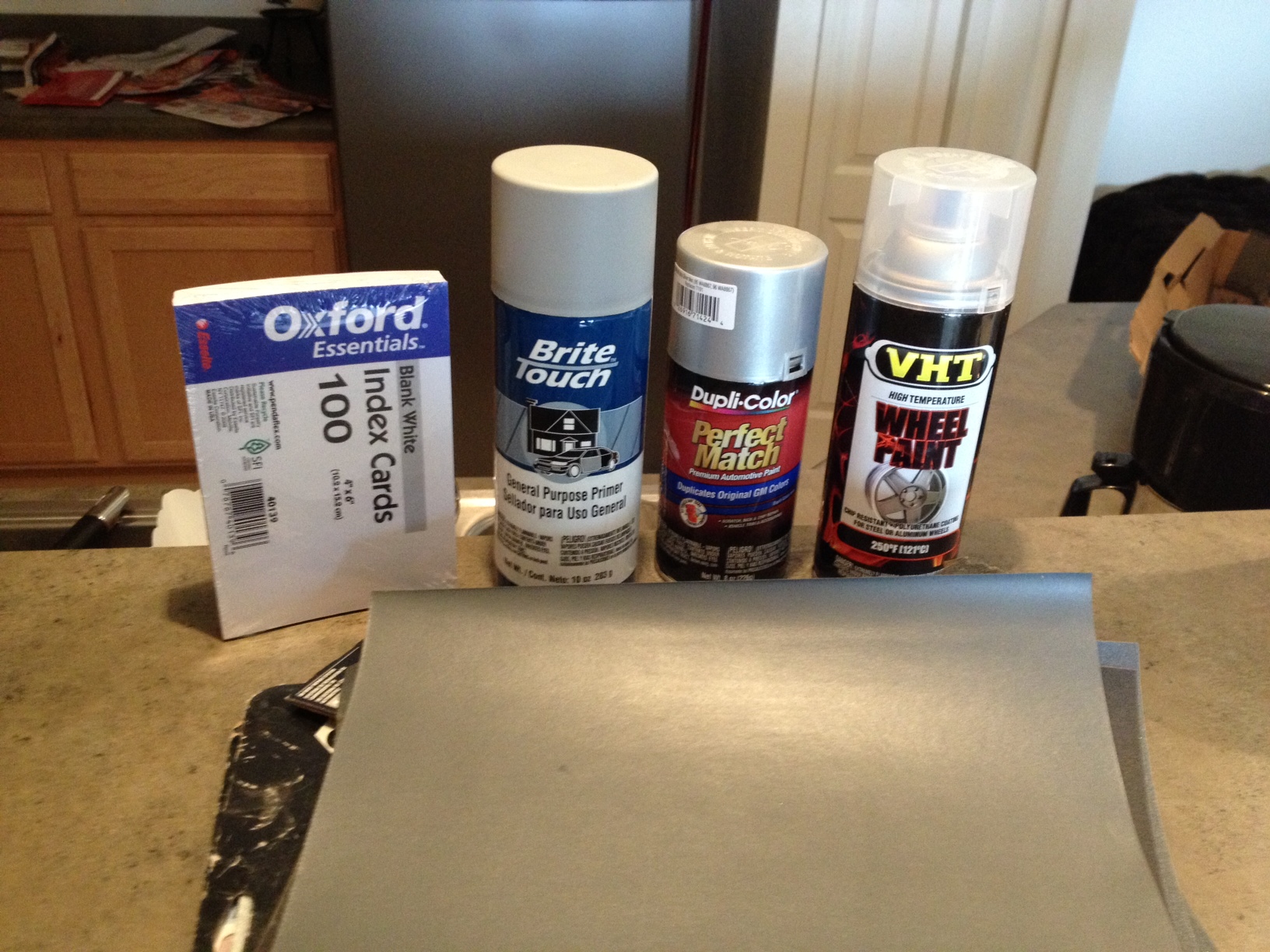

What you need:
-Sandable Primer
-Base coat (Duplicolor Perfect match GM Ultra SILVER metallic T191 is pretty much a perfect match)
- Clear coat ( VHT wheel clear coat worked great for me)
-sand paper ( grit #80,120,180,220,320,500...depending of condition of the rims)
-index cards
-bondo ( if bad curb rash)

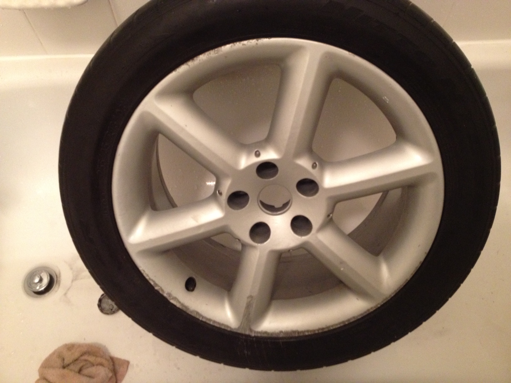

wash your wheels. I used purple power to degrease them.
Step 2

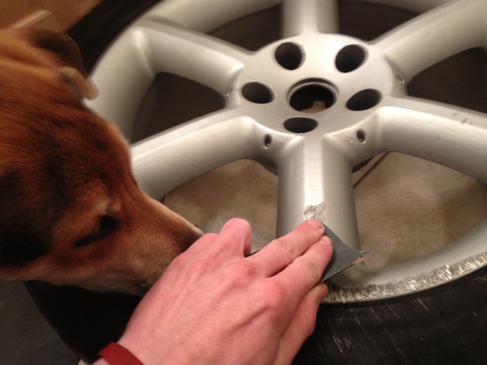

Sand down your scratches/ curb rash as good as possible.. I had to start with 80 grit because one of the wheels was really bad. I worked my way up to 180 on that bad curb rash to get it good enough for Bondo. If the damage is not too bad , sanding might be all it needs and you can skip step 3.

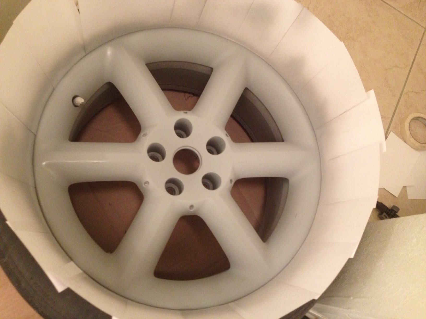

Dust off the wheel with a rag. if you use a wet rag make sure your wheel dries completely ! Stick your index cards between the edge of the rim and the tire to avoid overspray on the tire. Spray primer on your wheel. first coat really light. Then 2-3 light- medium coats until the whole wheel is completely covered. Wait 10 minutes between coats and 30 minutes before you apply the silver paint on top of the primer.

Apply a really light first coat. then 1-2 light coats and finish with a medium coat. Make sure you have a complete and even coverage... Like the primer you have to wait 10 minutes between coats and 30 minutes before you apply your clear coat.

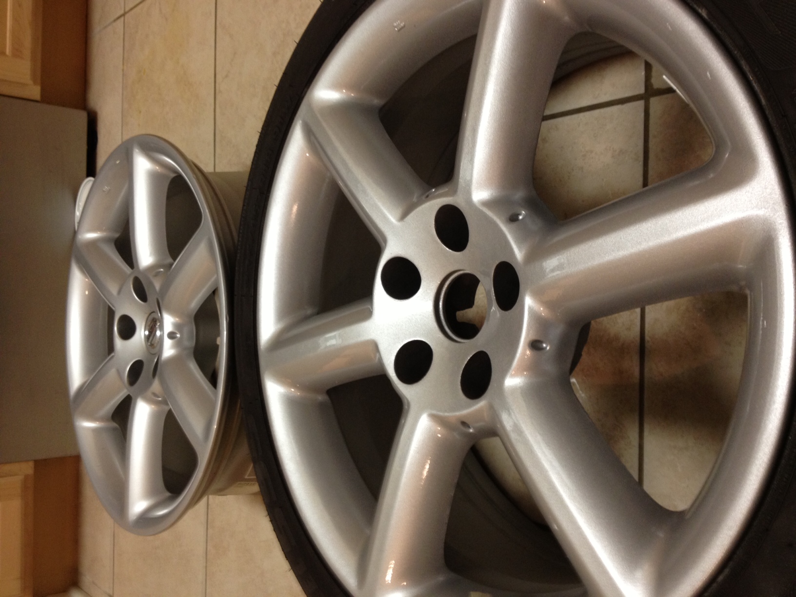

In my pictures, the wheel with no tire on it is a brand new OEM wheel..I only painted the 3 other wheels .. as you can see, the wheel I painted and sat beside the OEM rim matches perfectly!!
So you can probably use the Duplicator GM perfect match for touch up work on curb rash.
