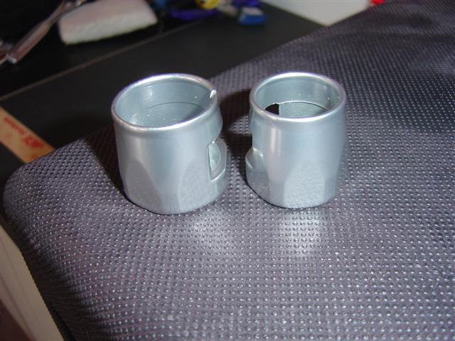

here is a 'chrome' powdercoat I can do.

2 ways to do it. You send me your calipers and I powdercoat them, or you get on my waiting list, (currently 2 people) and when its your turn, I powdercoat a set of calipers, send them to you and you send me back your old ones in exchange.
Prices I charge are
$125 basic coating, including shipping
$100 to sand the visible parts of the brakes smooth before powdercoating
$ 15 for JVD Caliper stickers
$200 refundable core charge for exchange program. Due to slow returns in the past, I have put this restriction on the core charge. You have 2 weeks after receiving the brakes to get the old ones back in shipping. After 2 weeks, core refund will decrease by $10 / day until they are shipped. 2 weeks should be plenty of time to get them installed.
