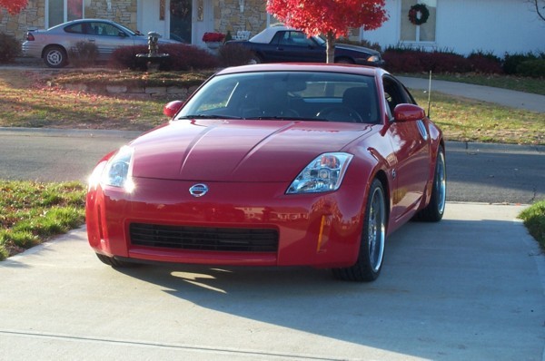

a) 19x10 with 32+ offset shown below...
b) ...40 is too much and will look like crap and also hit any coilovers. Nismo seems to think that 9.5 inch with a 30+ offset will clear everything. 35+ is too much for nismo coil overs. Yes nismo is referring to a 9.5 inch rim, or I may be misonformed so please see argument a).

What size and offset is the front?
Old Nov 27, 2002 | 07:06 PM
roberto350z's Avatar
roberto350z
Posts: 1,253
From: Sun Diego
19x8.5 and 29. looks good huh?
Yeah, that is nice. Do you have anymore pics of it?

may I please point out that no matter what anyone SAYS, the red car pictured above has 32+ for a 10 inch rim. This would indicate to me that anything 10" or less should definitey have less than 32+ offset. This red car is perfect....
https://my350z.com/forum/showthread....hlight=IFORGED
im gonna bump that thread right now.... bye bye
