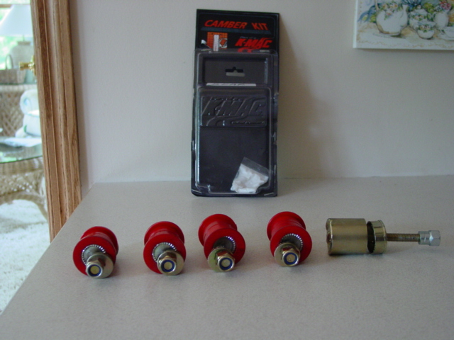

Actually there is an alternative to the SPC bolt. It's an eccentric bushing that does the same thing and you don't have to drill anything. It's made by K-Mac in Australia and has been out for close to 2 years now. One or two guys in the forum have them and I haven't heard any complaints. K-Mac doesn't do much in the way of advertising so they aren't well known.
They come in a set of four and you replace the bushings in both the stock front lower link (aka camber rod) and the rear lower link (aka spring perch).
Just passing this along not making any recommendations.

hmm interesting.. you say front lower link as well? I'd love to hear from someone that has tried these.
That's what they say. K-Mac still hasn't come up with anything for the front suspension yet.
I tried doing a search for the original post about these but the results don't go back far enough. The first guy that bought them was the one who posted the picture I put in.
