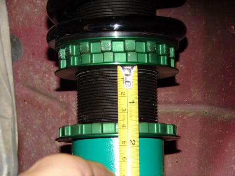

i recently installed tein flex coilovers. i set the height by the recommended settings from tein, which is a 25mm distance from the lower shock lock to the lower spring seat lock. i didnt notice hardly any drop and i can't find how much that actually lowers the car. i couldnt find it on teins site and couldnt find it by searching on a few forums. anyone know how much the recommended settings actually lower the car?
i lowered the car even more today by making the distance mentioned above 35mm as shown in the pic below. any of you with this setup know how much you're lowered and what the distance is between the two locks that i've got shown?

I set mine to the recommended settings:
I have a G35 coupe, so it sits higher than the 350Z so maybe it dropped more than yours. Here is my drop:

Also, if you drop the spring perch too much you'll get clunking as the spring loses it's preload. You may have to undo the lower control arm and spin the lower shock body up so you don't change the preload.

i set mine to the recommended settings at first. i road around for a couple days to see if they would settle at all, but they still seemed to not drop as much as yours. so i adjusted them to 35mm in the D section of your pic instead of 25mm. i'm trying to figure out what drop the 25mm setting gives.
i've also read that you arent suppose to drop the car too much by raising the lower spring seat. i just didnt know what other way there was of adjusting it.

The lower green part of the front shock is just an empty tube, the black threaded part is the shock itself. Raising or lowering the green part adjusts the height without affecting the spring preload or piston travel. I would put everything back to the recommended settings, then only adjust the height with the lower green part by loosening that single lock nut and threding the green part up.
If you get an idea of how many inches lower it needs to go, you can probaly get the lower green part at the right spot (measurement C) the first or second time.

cool... i'll give that a try once it stops raining. thanks for the tip. i had no idea you could adjust it that way. all i've ever owned were struts and springs, never coilovers. i bet the lower green part somehow threaded itself down too far while i was handling them. i noticed the bottom part spinning, just didn't think anything of it. i'm sure that's what happened.
