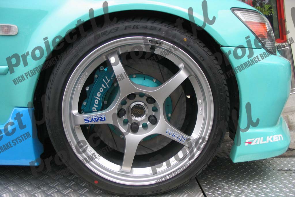

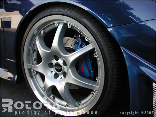

Here's some examples, note how the design of the slots on the Project Mu rotors is reversed, even though the rotor is installed correctly.
From left to right:
Stoptech
Rotora
Endless
Project Mu
