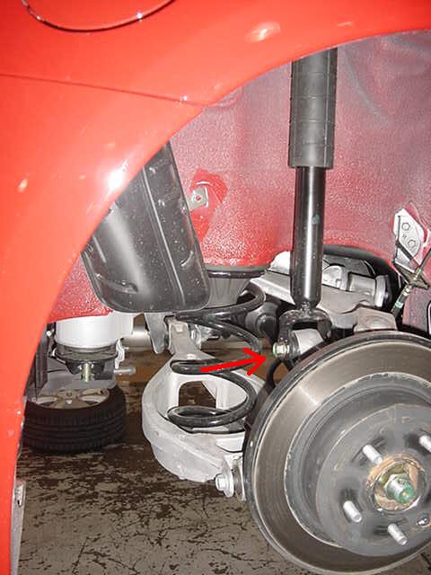

I think I may have figured out the reason for all the noise in the rear... I have tried isolating every bit of the rear coilover to find where the noise is coming from. (squeaking, thuds) After many attempts with no solution and even two different coilover systems (buddy club and Stance). I believe the problem to not be with the coilover unit at all.
Instead the problem is with the lower mount of the rear shock. Which is a weak rubber bushing. This bushing was originally intended to only withstand the dampening force of the factory shock absorber where most of the weight is resting on the spring in the OEM location.
But with a true coilover in the rear you are now putting all the weight of the rear plus all the force of shock on this single bushing. I looked at it closer this morning and mine is starting to crack and is no longer doing its job. I believe this is what is making the noise.
Please everyone with true coilover in the rear check and see if yours is wearing pre-maturely. If this is the case, we need to fabricate some spherical bushings for this location.

My rear suspension lifts a wheel coming in at angles all the time.
Any one know of any shops that could make some spherical bushings?

^ maybe you could ask Alex @ Battle Version.... i'm sure if he knows it is an issue, he would have some made, ... I think getting a polyurethane bushing in there might be better for daily driving...
Or try SPL or possibly SPC. SPL is already making the aluminum rear diff bushings...

Originally Posted by SPL PARTS
We are planning to produce spherical bearing bushings for the rear spindle,
however it will be a few months before we get to them as we are working on
other 350Z products right now.
FYI we are not certain if this is a complete solution for your setup, while
the spherical bearing bushing can take the loads involved, the
spindle/upright is aluminum and the area around the bushing is not as
substantial, relative to other applications such as the Z32 300ZX where the
spindle is also aluminum and the coilover mounts on the spindle from the
factory, the size of the spindle and bushing on the Z32 is much more
substantial.
Even though SPL says the spindle isnt very substantial, Spherical/metal bushings will help with the noise and integrity of the suspension.

Originally Posted by Alex Pfieffer @ BattleVersion
Hey Tony,
Yeah, I've always looked at the rubber bushing and figured they would go bad. I just didnt know how long it would take before I would start hearing complaints about it. I havent looked into making something to eliminate that bushing yet and I'm not sure when I'll have time. I've been really busy laitly so its something thats going to have to wait till the off season.
Alex
Anyone else interested? I'll start looking into materials to make this part.

i think SPL is dead on with their view, ... i think the aluminum bushing Will help, ... but i'd worry how it will affect the upright, ... i mean b/c of the small size of the upright, i could see an aluminum bushing weakening or cracking that 'housing'. That's the reason i was weary of going with true coilovers...
I'm sure there will be a full spindle/upright replacement within the next year...
But for people who need something now, ... I would think you could get a properly sized urethane bushing (which I think would put less stress on the upright) from prothane or senergy suspension ....they list quite a few sizes for their shock mounts/etc on their website(s)... you can probably also get a urethane spring isolator to help with the noise...
