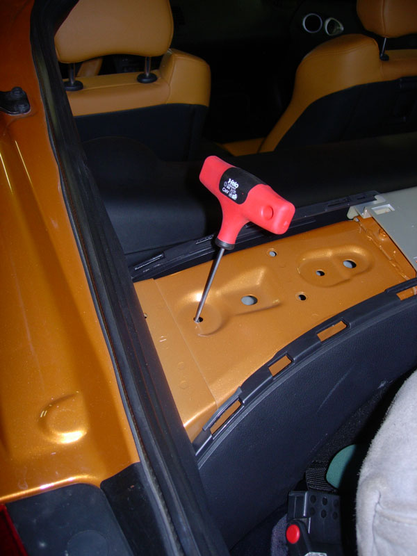

I finally found that with allen key I bough that I can make the adjustments from the existing hole:

The allen key I bought (in the picture) is 12cm long, but I think around 8cm long will be fine. It helps having the handle too - because it's easier to see how many turns (or half turns) you have just made.

Did you have to bend it at all? Or does it slide in nicely? Just worried about rounding out the adjuster.

No need to bend it.

DRILL out the hole nearest to the X, by elongating it with a 1/2" bit. Then you need a long allen wrench to adjust it. The TOKICO tool is too short.
SEARS or your local auto store will have a 3"-5" allen wrench to reach in there.
Works for me.
