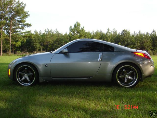

I have 20's. So you are saying they will bolt right up as long as I have wheel clearance? I hope so. My brakes are WAY too small for my wheel as far as looks go.

They SHOULD clear, I am not sure of the specs on your wheels but if I had to guess it should. If you are talking about buying the factory BREMBO's brand new, I would look for different alternatives as you can find much better braking systems for the same price as the factory BREMBOS. Check out the link below.
