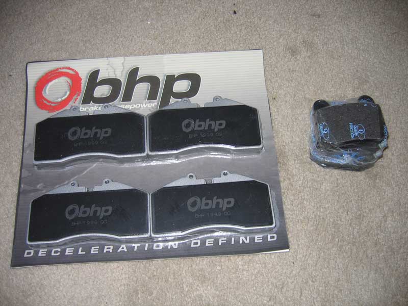

I'm curious myself... I have a pair waiting until my axxis ultimate's wear out...
