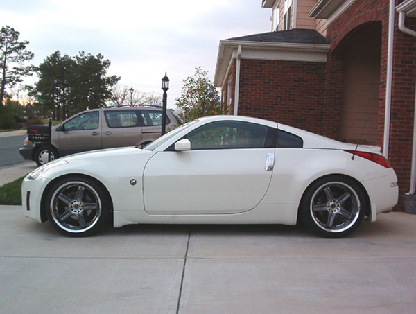

Default Eibach w/18 inch SSRs
zxsaint:
This may be another bad angled pic. I just had the Eibach's installed today and it's not too too "gappy" for me. The ride is much better, however.
You also won't be able to define where the tire sits because it's dark in there. I'll take some more when the sun comes out tomorrow and will post if you'd like better pics.

whos ever white Z that is, its dam hot! those wheels look great, and the eibachs seem to be cool too......

DAMN!!! Thats insane!---man I got mine done for $100(install)--$220 shipped for the springs!
They should charge $50 an hr(Labor)--it only takes like about 45mins--alignment was another $60
19" wheels are a ***** to find someone that can aligned----but mine turned out great!!! I love em!!!
