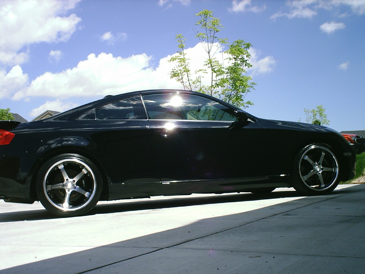

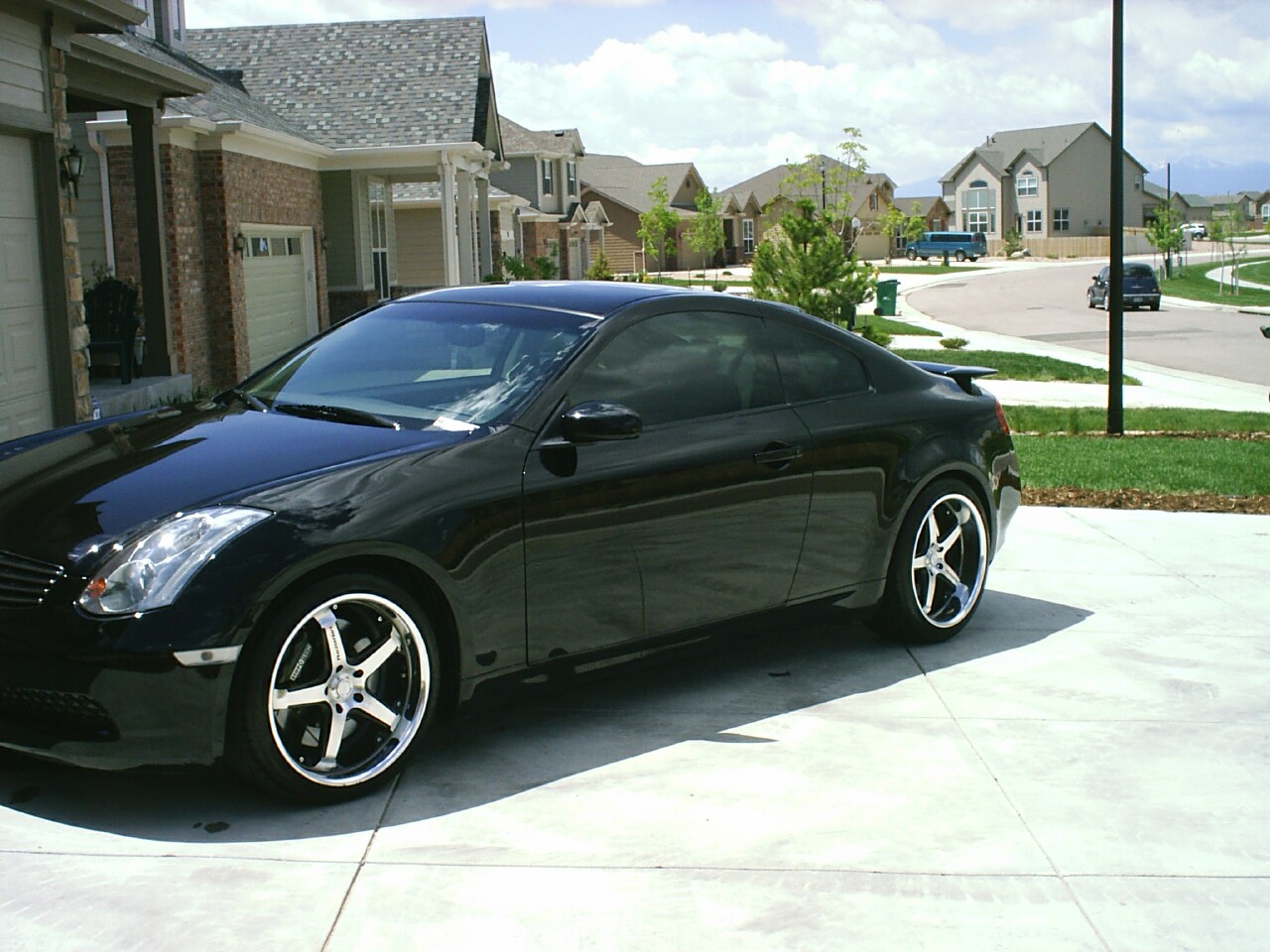

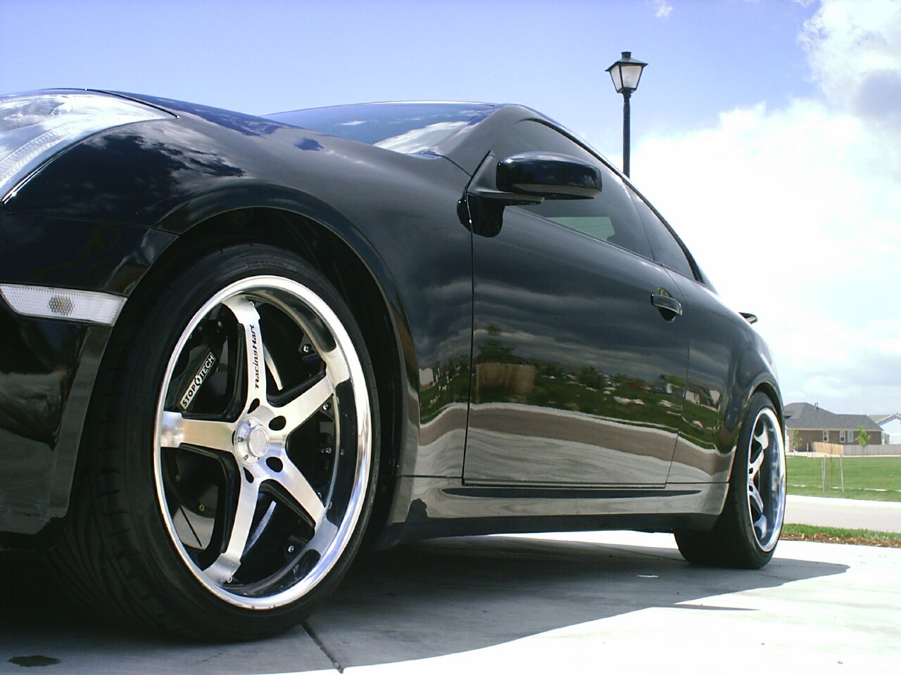

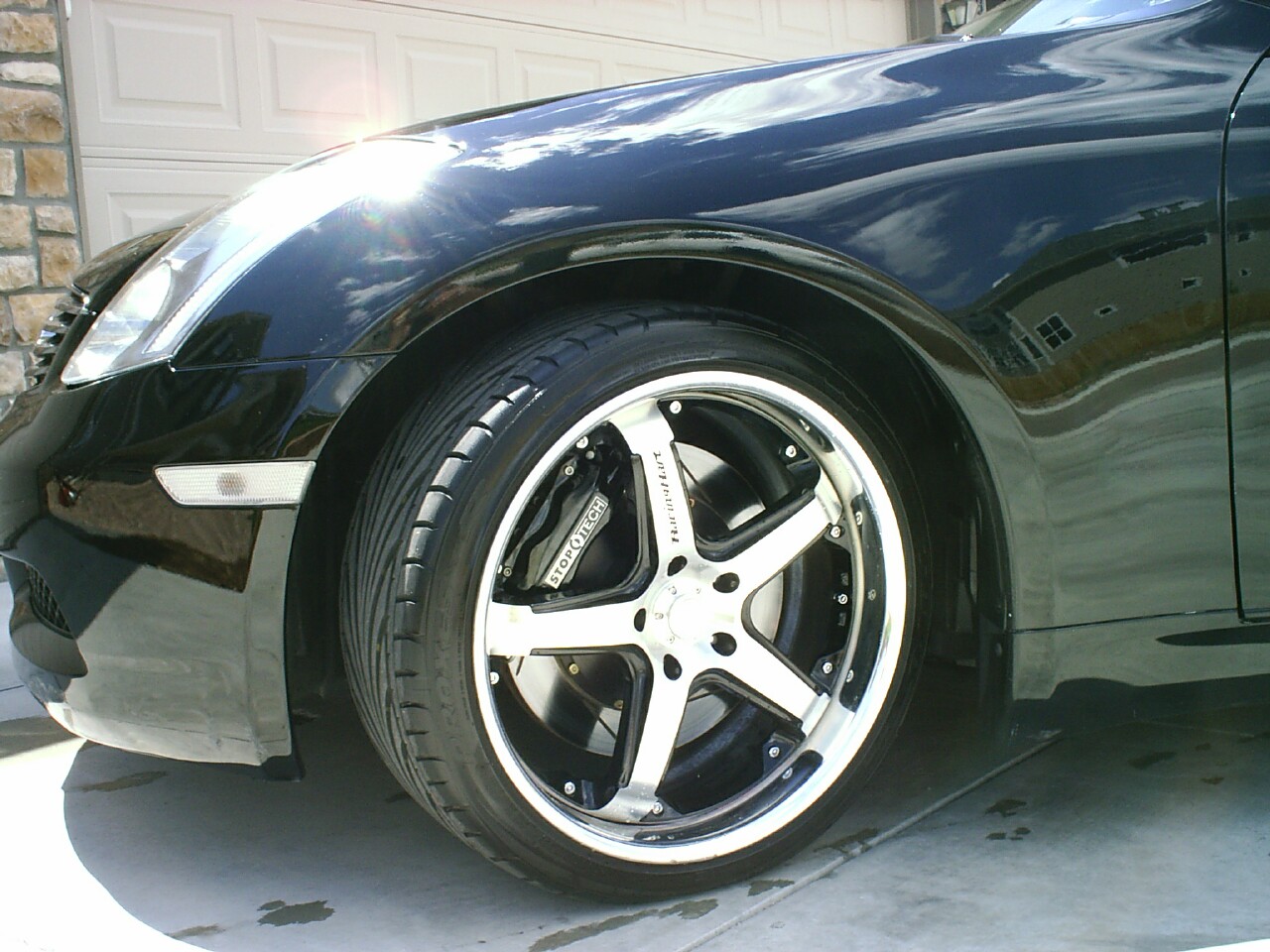

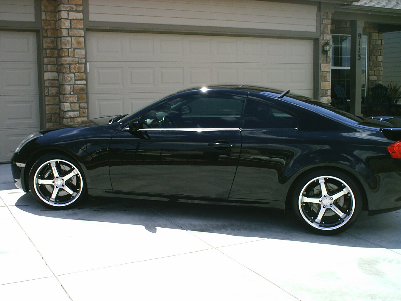

Here's some pics of my 332/328 4/2 stoptechs in black, on my black G.
Dave
Attached Thumbnails Black BBK's with Black Wheels-driver-side-low-front.jpg   Black BBK's with Black Wheels-driver-side-front-high.jpg   Black BBK's with Black Wheels-right-front-close.jpg   Black BBK's with Black Wheels-right-side.jpg   Black BBK's with Black Wheels-psgr-side.jpg
