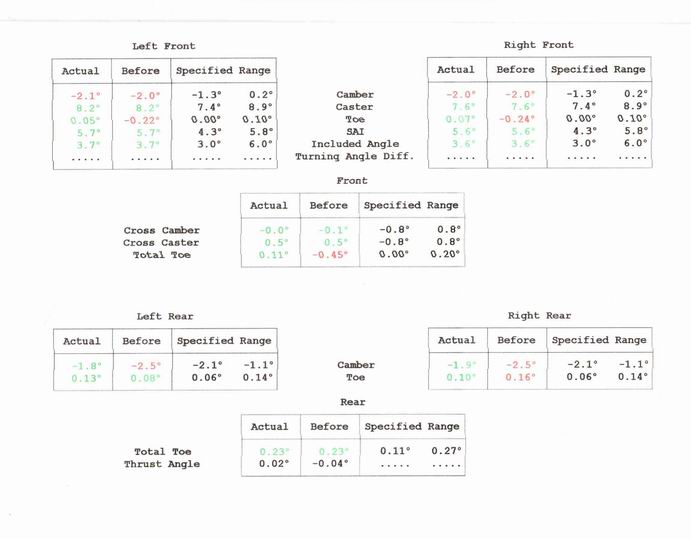

I have a fair drop in ride height, nothing like some of the Zs on this site. The front is slightly lower than the rear but that is by choice as my exhaust hangs pretty low. So with the alignment I figured see how bad it is after adjustment and then go from there. I will be putting on front camber arms and getting another alignment done. One thing I found very odd is that the shop said I had no camber adjustment up front which I thought was the case for the rear.
I scanned the printout from my alignment.
Originally Posted by pss350z
I wanted the car alignment done to suit my chosen height.
Attachment 152183
Attachment 152183
the car has no adjustment for front camber at all, and for rear, its so insignificant it's not worth mentioning
you need camber arms up front and something like the SPC kit out back to have full control over front/rear camber/toe
