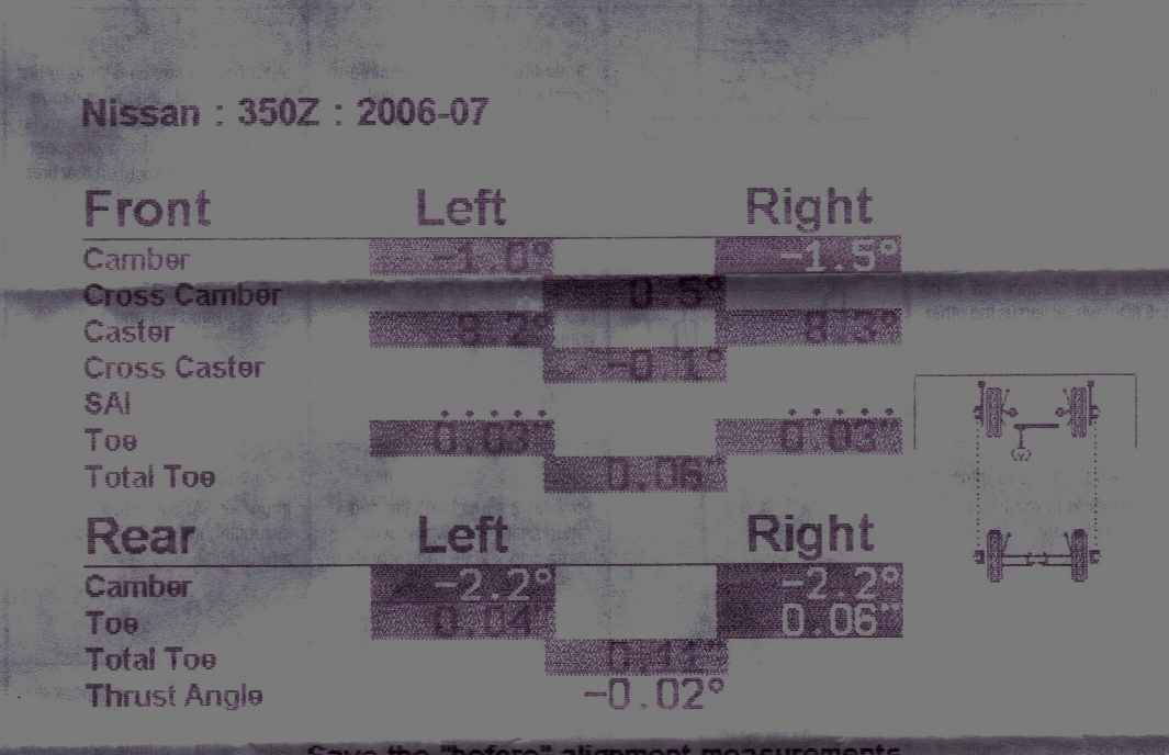

I have my z dropped on Eibach Coilovers, the height is identical on bouth sides , but my front camber is way different.
Any ideas, besides getting a - arms?

0.5 Cross camber is fine. You could get the arms to make them perfectly even, but you dont need to.

is that with or without you in the car? When you get in, the left side suspension will droop some more and increase the camber on that side anyways. I would be more worried about the rear, that is quite a bit of negative camber

That’s without me in the car… so you are correct it gets worse with me in it.
The rear will be fixed ! I just rolled my fenders so I can finally fix that....

so you rolled the rear fenders? does that mean that you could have put the rear toe with in specs but your wheels/tires would not let you??? I want to get these springs on my z and i like all the specs except for the rear camber.
