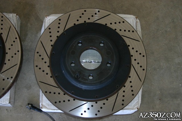

Is the rotor a 2-piece or 1-piece rotor?
not sure here is a picture

looks like a two piece

ok there two piece I found out through the website, go figure.

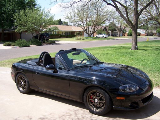

Powdercoating is stronger than paint, however, I painted the hats on the rotors of my 2001 Miata (flat black) to get rid of the nasty rust color that the iron likes to turn. It lasted wonderfully w/ no chipping etc. I just prepped with a steel brush and brake parts cleaner. Then sprayed about 4 coats. Notice in the pic that you can't see the rotor hat, that's b/c it blends in being flat black..
