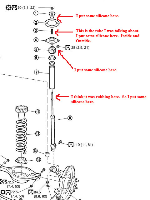

I figured it out. I put some silicone on the threads in the top cap bushing area (inside the sleeve) where I keep thinking the noise is coming from and let it dry overnight. Today I do NOT hear this annoying noise anymore.
A little silicone will do wonders. I just thought I would let everyone know if anyone has this problem.

hey i have had squeaking for almost a year now, what do u mean "threads in the top cap bushing area (inside the sleeve)" because i would love to try that i just don't get what part ur talking about.

Here's a diagram of what I am talking about.
